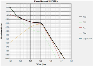

Figure 1, there is a difference between the measured value at 100kHz and the simulation.
What could be the factors that cause these characteristics?

Figure 2 shows the simulation settings.
Figure 3 shows 120MHz Fosc phase noise (SG: Keysight E4433B).
Figure 4 shows the TICS Pro settings(Raw Registers).

  • By the way, the loop filter constant of the evaluation board is the same as the simulation.

    The phase noise of the 120M REF to be used is as follows, and the simulation of the 12G band phase noise by this REF is as shown in Fig. 1.
    We have not confirmed the phase noise due to this REF yet.
    I am concerned that the characteristics will be the same as when SG is set to REF (the integrated noise will be worse).

    I confirmed the phase noise due to the 120M REF used.
    As a result, the 100kHz characteristic that existed when 120M REF was used as SG has disappeared (Fig. 1).
    In the loop band: The flat part is about 10dB worse than the simulation.
    This is probably because the phase noise of the 120M REF during measurement is worse than that of the 120M REF of the simulation (Fig. 2).
    It was confirmed that there is no problem with phase noise by using 120M REF, which is planned to be used, instead of SG.
    However, I'm worried that I happened to get the characteristics well.

    If I use Fig2 as the reference clock, I get similar simulation result as Fig1. The flat region is still affected by the reference clock. To get a lower phase noise in the flat region, we need to increase the loop bandwidth and to use a better phase noise reference clock.
