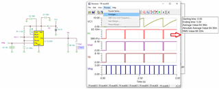

  • Hi Nan,
        Could you please help me confirm how calculate the supply current?
    I do not have NA555 PSpice model. I am going to use TLC555 as an example, and estimated the LDO's current and ratings in simulation.
    After you run a complete simulation with an actual simulated load and supply voltage, you click on the Icc current of the Vcc supply (15Vdc as the example).
    You click on Process --> Average --> the tool will prompt the Icc's Average Value --> In this case, the tool will prompt for Average Current Value of 84mA @15Vcc. So the LDO for the circuit should source a minimum 15V*0.084A = 1.26W at room temperature to run the TLC555 circuit.
    TLC555 Current Calculation 03162023.TSC
    If Vcc of 15Vdc is generated from LDO, you need to size the LDO with a proper power --> you need to make sure that LDO is capable to source and sink the required currents per the LDO's Safe Operating Area (SOA) over temperature. From the LDO's SOA curve, you will get a minimum wattage of LDO required for the application. Then you double, triple or quadruple the minimum wattages (SOA) for the application as the safety considerations (You'd like to keep the LDO as cool as possible without overheating under the worst case operating conditions).

  • Hi Raymond,
         Really appreciate your simulation based on TLC555.
         According to the  simulation, I find a way to evaluate the supply current almost.
         Iout =Vout/R4=6=9.16V/100Ω=91.6mA
         Considering the duty cycle, in the simulation, Iin=91.6*(T_high/(T_high+T_low))=88.02;
         I_without the load=0.3mA
         I_supply_current=88.02+0.3mA=88.3mA, which is really close to the absolute average 88.36mA;

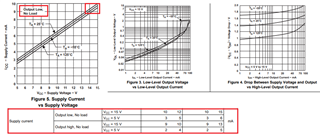

         According to the datasheet, I_supply_15V_withou_load=9mA
         If we ignore the duty cycle, we can get the max of supply current:
         I_max_supply_15V_without_load=9+1.43=10.43mA.
         Could you please help to review my calculation to evaluate current supply of NA555?

  • Hi Nan,
    Here are some of my comments.
    Your calculation is ok for TLC555. This current figure is correct for the worst case analysis, which the TLC555 timer is a low power device.
       Based on the calculation above, we can calculate the supply current of NA555 roughly:
    NA555 consumes more power when there is no load, as shown in the table below.  You should use the worst case of 15mA at Vcc = 15Vdc.
    Since I do not have NA555 PSpic model, the simulated current consumption is only applicable for TLC555 (low power timer).
    Please try NE555 timer, which the current consumption may align more closely with NA555 device.
    If you have additional questions, please let me know.
    Raymond
