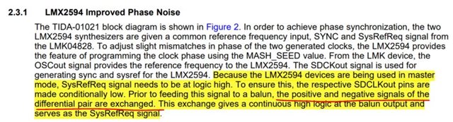

2. In the application note about TIDA-01021(Multichannel JESD204B 15-GHz Clocking Reference Design), it is mentioned that SDCLKout of  LMK04828B should output logic high to let LMX2594 work in master mode.
Firstly, SDCLKout pin is made conditionally low. But then, how to exchange the positive and negative signals of differential pair? I couldn't find any register about changing polarity of differential pin?

     2. I believe that this in reference to the physical wires from the output to the balun being exchanged so that the signal's polarity is flipped.
    [Jason]: Yes, you are right. I check the schematic, and N is connected to + , P is connected to -. This detail is not easy to be discovered if no enough carefulness.
