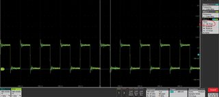

My test setup as below figure shown, signal generator(E8257D) provide reference 10MHz clock to CLKin0 pin of respective LMK04828B on the different board through PD1, for common clock reference;
Another demo board provide the one-shot SYNC pulse to SYNC pin of respective LMK04828B on the different board through PD2, for reset the internal divider .
After one-shot SYNC, I can see that alignment between 5M sysref on the respective LMK04828B. But there is some residual skew between them, about 315ps as below figure shown. Through many power on/off, this kind of residual skew would exist and change, such as -36ps or 61ps. It seems that  phase relationship is not fully deterministic. Maybe my way is wrong. So, How could I do to realize deterministic and alignment phase relationship between output clock from LMK04828B on the different board?

    Add some other test results: 125M clock output from DCLKout of LMK04828B.
    The below are clock waveforms of two LMK04828B on the different board for three times power on/off. This kind of residual skew change very obviously。
    Up till now, is there any mistake operation in the my process of synchronization across multi-LMK04828B across boards?

  • Shen,
    Only divider reset simultaneously is enough for aligning clock output on the two LMK04828B?
    No.  Your current configuration will not be able to achieve deterministic synchronization.  This is because the sync pulse will synchronize the SYSREF divider to the VCO output which is not deterministic to the VCO on the other LMK04828 therefore resulting in the skew.
    In order to create a deterministic relationship you will need to use nested 0-delay mode to create a phase relationship between your input and SYSREF signal.  Then, when you reset the dividers with a SYNC you should see your SYSREF signal without any skew.  I have attached an updated config file with the necessary changes.

    many times of power on/ off, 5M sysref clocks just are full 180deg out of phase always
    and 125M clock are 180deg out of phase too
    At this moment, I remember that input10M reference clock is great than output 5M sysref  clock which loopback to N divider of PLL1. Is it violate the first rule of ZDM mentioned in the application note of "Multi-Clock Synchronization"?  Every power on/off phase difference always is 180deg. It seems that phase relationship is deterministic but not alignment.
    So, I try to change the 10M reference clock to 5M reference. Test show that 5M sysref clock just always are in the phase.
    Many thanks to you !
