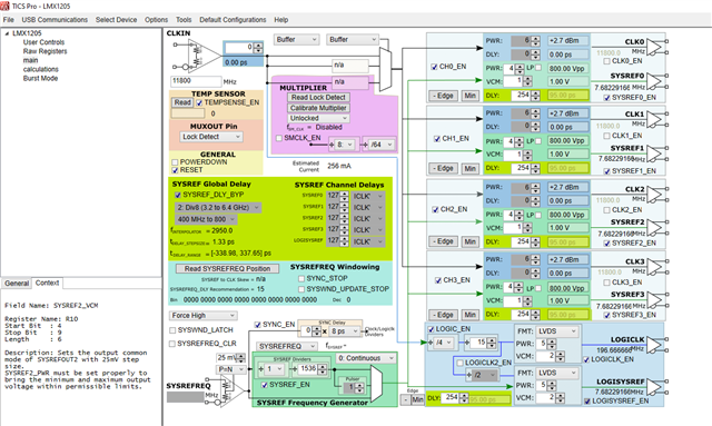

 We are facing some issue like, Register file which was generated through TICS Pro loaded in the device and we are able to readback the register. But output LOGICLK & SYSREF signals are not generated. What could be the problem?

    A few thoughts:
    • The RESET bit is set to 1; any time you write R0 (such as, for instance, at the end of a "write all registers" operation), all register states are reset. This should be set to 0 during normal operation. TICS Pro includes an initial write to R0 which clears the device.
    • The SYSREF_DLY_BYP bit is set. I'm not sure if you want to do this in generator mode, since it bypasses the delay generators, and all SYSREFs just come out of the outputs at whatever the propagation delay of the internal routing allows.
    When I load your configuration, clear the reset bit, clear SYSREF_DLY_BYP, and push Ctrl-L to load all registers, I find that the device produces both LOGICLK and continuous SYSREF output.

    and some of the registers are mentioned as undisclosed in datasheet. And has recommended data to be written.
    But in TICS PRO it can be change. Is that affect the output generation in buffer mode?
