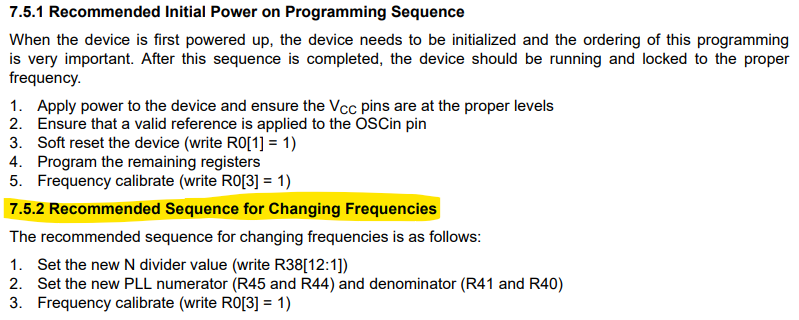

Hello Team,
I believe we should write register R64 to R0 (high to lower register#) for the initial power on programming.
However, do we need to write from high to lower register# during frequency change or some setting change? Or we can write in any order?
