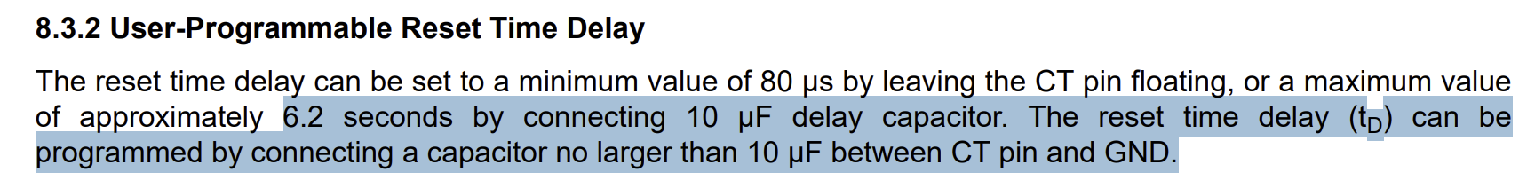

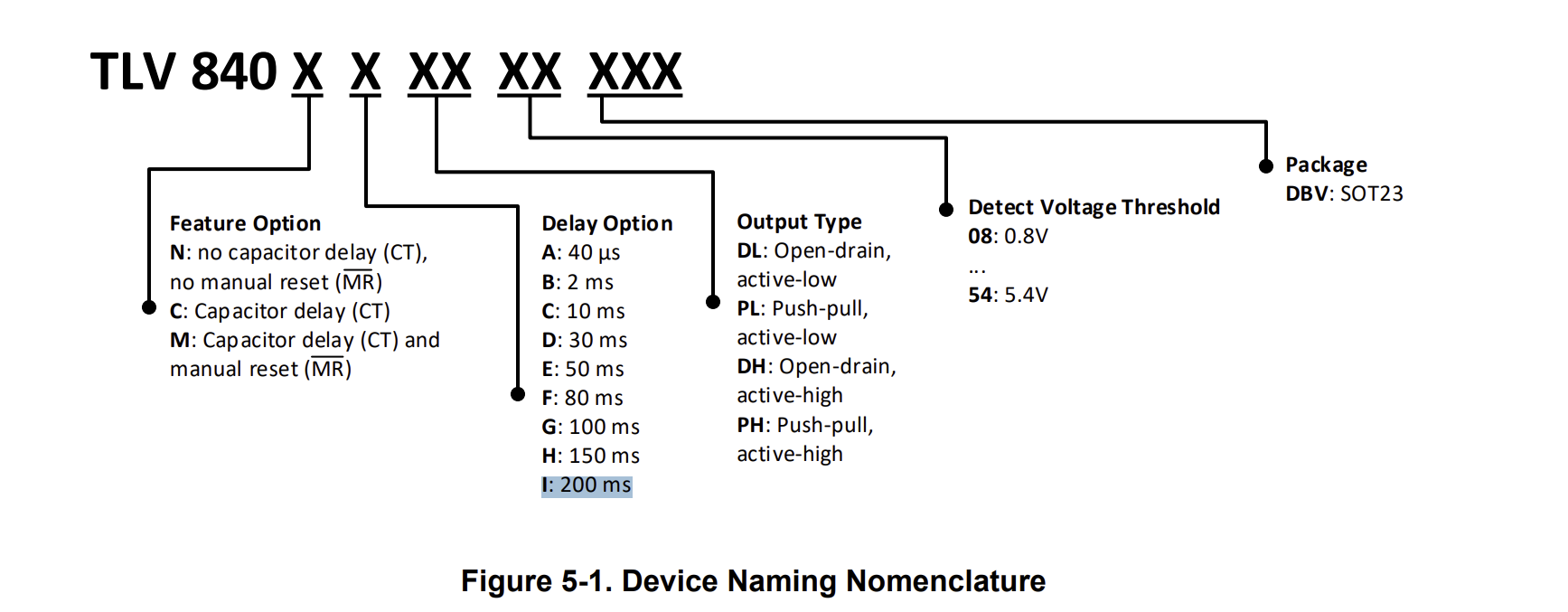

  My customer want to use TLV840 family device and need to design 1Sec reset delay request.
 we checked the max delay option was 200mS (I verion) max as below Figure 5-1
However, we reviewed the CT pin can place 10uF to set max ~6.2sec delaty option,
May I know which full PN we can set to delay time =1Sec requirement ? thank you
