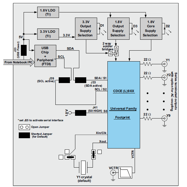

    In CDCE(L)9xx Performance Evaluation Module, I find that for the outputs supply, a selection between 3.3V and 1.8V must be done.

    You are correct here Mourad. Internally, the Vddout pins are connected but do need to also be each connected externally. As you mentioned previously, this is a common tactic used for power supply decoupling - noise on supply planes can directly impact clock phase noise in a noticeable manner. It is safe practice to provide a good supply path to all Vddout and Vdd pins regardless of their internal connections.
