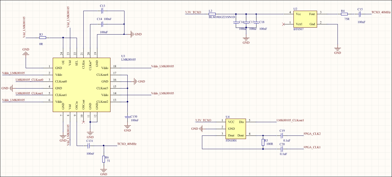

  • Hi, Arvind
      Thanks for your reply.
      According to your suggestion, I finished my design, as the following diagram, is it right?
  • Hi Peter,
    Could you please attach a better picture of the TCXO to device interface? I cannot read the schematic clearly. From what I see the series resistor at the output of the TCXO is in Kohms.
    The output impedance of the TCXO is typically fairly high if it is clipped sine wave. If it has a LVCMOS output, the impedance is typically in ohms. The idea behind adding the series resistor is to match the driver impedance to 50ohms when driving a 50 ohm PCB trace. If the TCXO output impedance is already higher than 50 ohms, there is no need to add this resistor.
    Arvind Sridhar
  • Hi, Arvind
    Oh, sorry, updated. Pls check the attached pdf, the TXCO datasheet attached also.
    The series resistor at the output of the TCXO (R4)  is 75 ohm.
     0181.BT0507.pdf
    2063.LNK00105-TCXO.PDF
  • Hi Peter,
    The second link is broken/corrupted. From the TCXO datasheet, the output can be HCMOS or Clipped Sine Wave. However, I think the 75 ohms should work fine.
    Arvind sridhar
  • Hi, Arvind
    Pls check the attached pdf. it is pdf-1.3 file.
    0027.LMK00105.PDF
