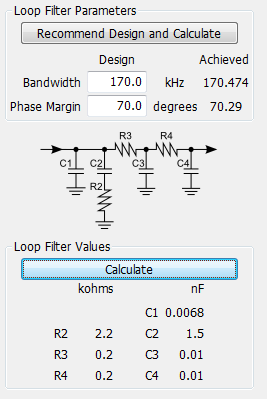

I'm currently working on LMK04821 to generate 2GHz clock. Here are some configurations on my board.
1. PLL1 is shut down. A 20MHz CMOS clock, generating from an OCXO, goes into OSCin PIN directly.
here is the phase noise of the OCXO:
2. PLL2_DLD is configured to be connected to STATUS_LD2 internally.
here is the external loop filter configueration of PLL2:
From the FFT analysis of the DSO, the output of 2GHz clock should be locked by PLL2.
However, the output of STATUS_LD2 is an abnormal waveform instead of a constant high or low, as shown below. Does this means PLL2 is still not locked?
Thank you so much!!
