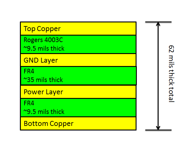

I am making a PCB based on LMX2582EVM design. I would like to know the PCB stackup for the LMX2582EVM demo board (i.e. dielectric material used, its thickness, thickness of output traces, etc.).
My current design is using R04003 material and thickness of 8 mil. The output trace thickness is 20 mils. (this gives me a 50ohm impedance trace).
It would be good if someone can help me here with LMX2582EVM stackup and to confirm if my design will work with the aforementioned specs.
