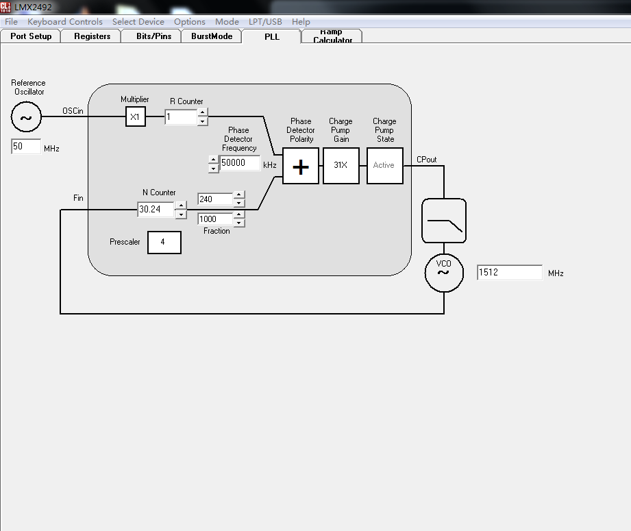

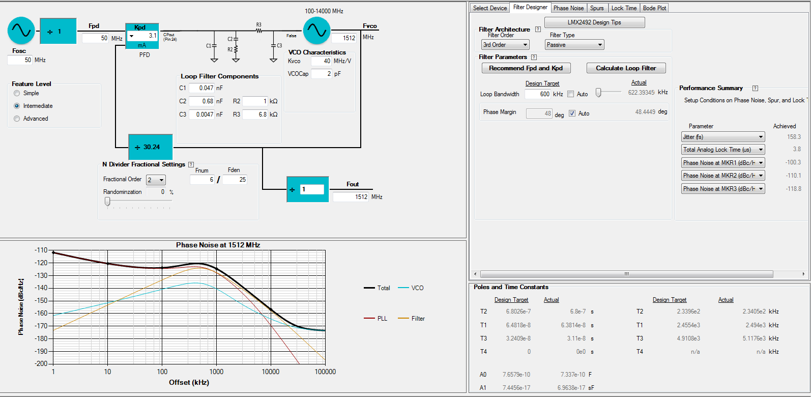

        I am not using TICS Pro but TI PLLatinum Sim to simulate PLL system  My PLL configuration is like this
    but there are two uncertain parameters, Kvco and VCOcap in this configration,does it matter? and my register setting using codeloader4 set like this

  • Hi Li,
    Your loop bandwidth is very high, but it should work as long as the simulation environment matches with actual. You have to find out the exact Kvco and VCOcap of your VCO and simulate again. These parameters will affect the simulation very much.
    In the PLL tab of Codeloader, it looks fine but you need to confirm that the slope of your VCO is positive. That is, output frequency increases with Vtune voltage.

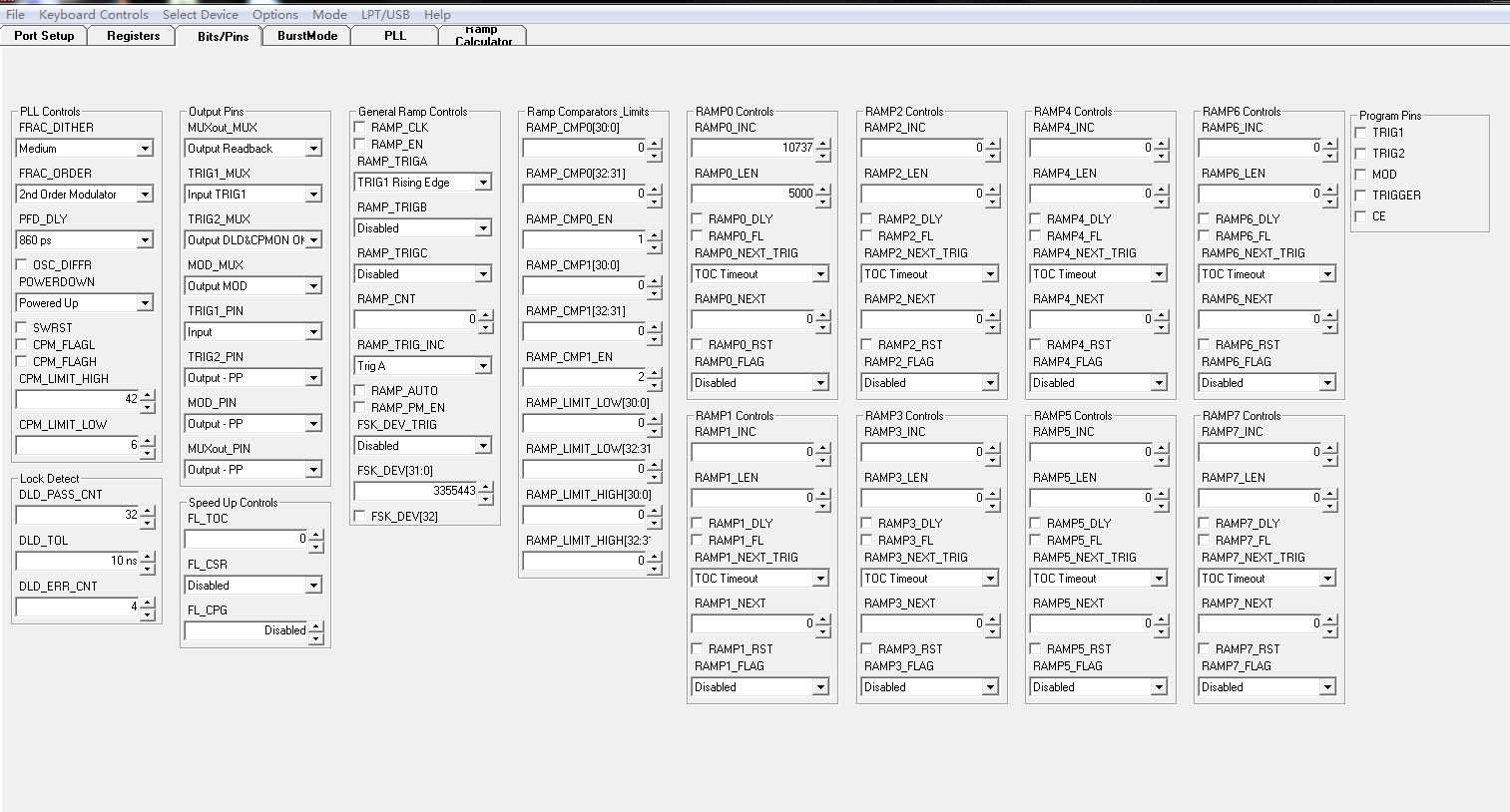

    Please provide the Bits/Pins tab plot for review, thanks.

       My loop bandwidth sets 600kHz because the LMX2492 datasheet says that ‘Cycle slipping typically occurs when the phase detector frequency exceeds about 100x the loop bandwidth of the PLL’  in the 11th page,and my phase detector frequency is 50MHz.
        Then I will confirm Kvco and VCOcap of my VCO as soon as possible to see whether it is its impact.

        The screen shot of Bits/Pins tab is like this ,
    Please help me check if it is wrong.

  • Hi Li,
    The configuration is fine, maybe you can try disable FRAC_DITHER, but this is not critical.

    I only know the range of the Kvco and VCOcap ,neither of them has a fixed value, I have tried some set of values,but it seems that these two parameters have no effect on this phenomenon,any suggestion?
