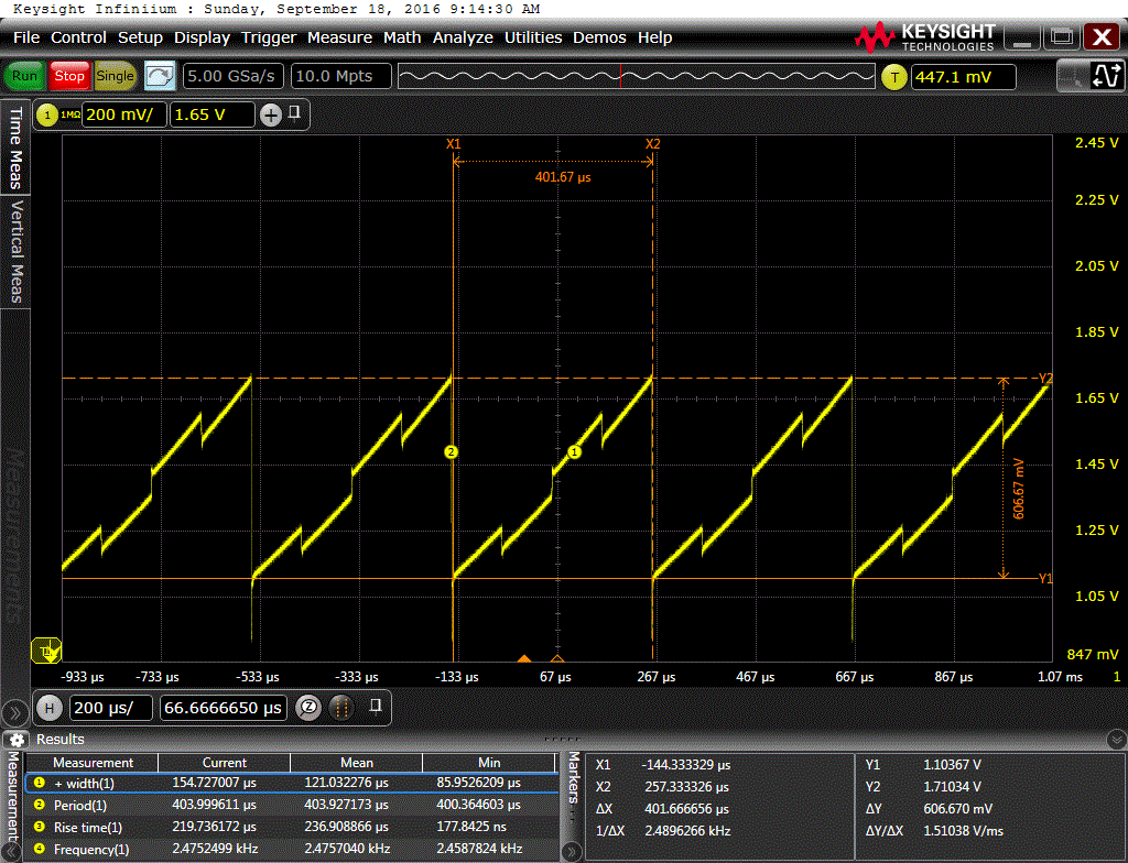

LMX2492 EVM can generate a signal like this

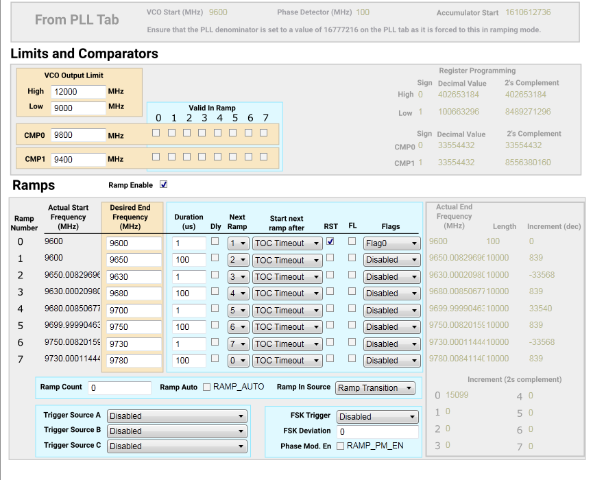

and my configuration is like this
this signal only have 4sections,if I want to generate a signal like this but have 8 sections,how should I configue???

The maximum number of state for the ramping feature 8 [0-7]. you have indeed use them all for the wave you are showing so using this method will not allow you to do more than 4 sections.
However, it appears you are trying to do FSK modulation on top of the ramp. you can use the FSK feature AND the ramp at the same time. Enable a single ramp and the FSK such as in this example:
You will get this sort of modulation and you can easily "sync" the FSK with the ramping as well...
