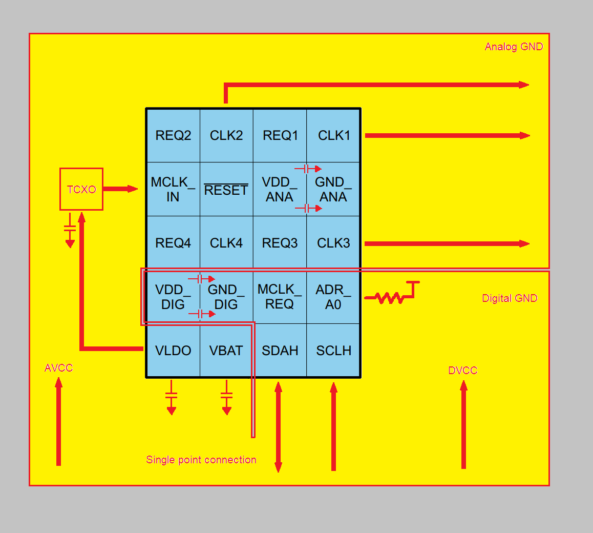

  • Hi Lane,
    Thanks for your reply.
    I plan to use 3 clock buffers, the clock request pins are not needed (I'm using I2C interface), and also RESET pin is not needed.
    Under these conditions, will the following solution is acceptable?
    (Decoupling capacitor for DVCC\AVCC will be located at the bottom side)
    Thanks again
    Nir
  • HI Nir,
    I don't anticipate any issues with it
    Kind regards,
    Lane
