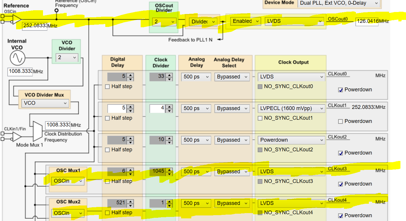

  • Well, I wanted to know how many VCXO associated pins are there in LMK04906. And how do they function?
    For example, attached is the TICSPro screenshot of the clock outputs. It has 3 possible outputs with Oscin. However, 2 of the OScin outputs are muxed and can be provided by a Internal VCO. Is the Oscin outputs, same as VCXO outputs? How many of such outputs does the VCXO of LMK04906 has in the pin diagram. Moreover, how many distinct frequencies it can generate, is it 3 for example, if the clock outputs are 3 (with different divider at each output).

  • Shikhar,
    Thanks for the clarification. The VCXO signal is delivered to the device on OSCin pins, and can optionally be buffered or divided out of any combination of the three outputs: OSCout0, CLKout3, and CLKout4. If used with OSCout0, the OSCin source can be divided by 2-8 or passed through as a direct copy of OSCin. If used with CLKout3 or CLKout4, the OSCin source can be divided by 1-1045 individually for each output. So you could get three distinct VCXO-based outputs from the LMK04906, with OSCout being slightly less flexible than either of the CLKout options due to the restricted divider range.
  • Thanks Derek, this answers my question.
