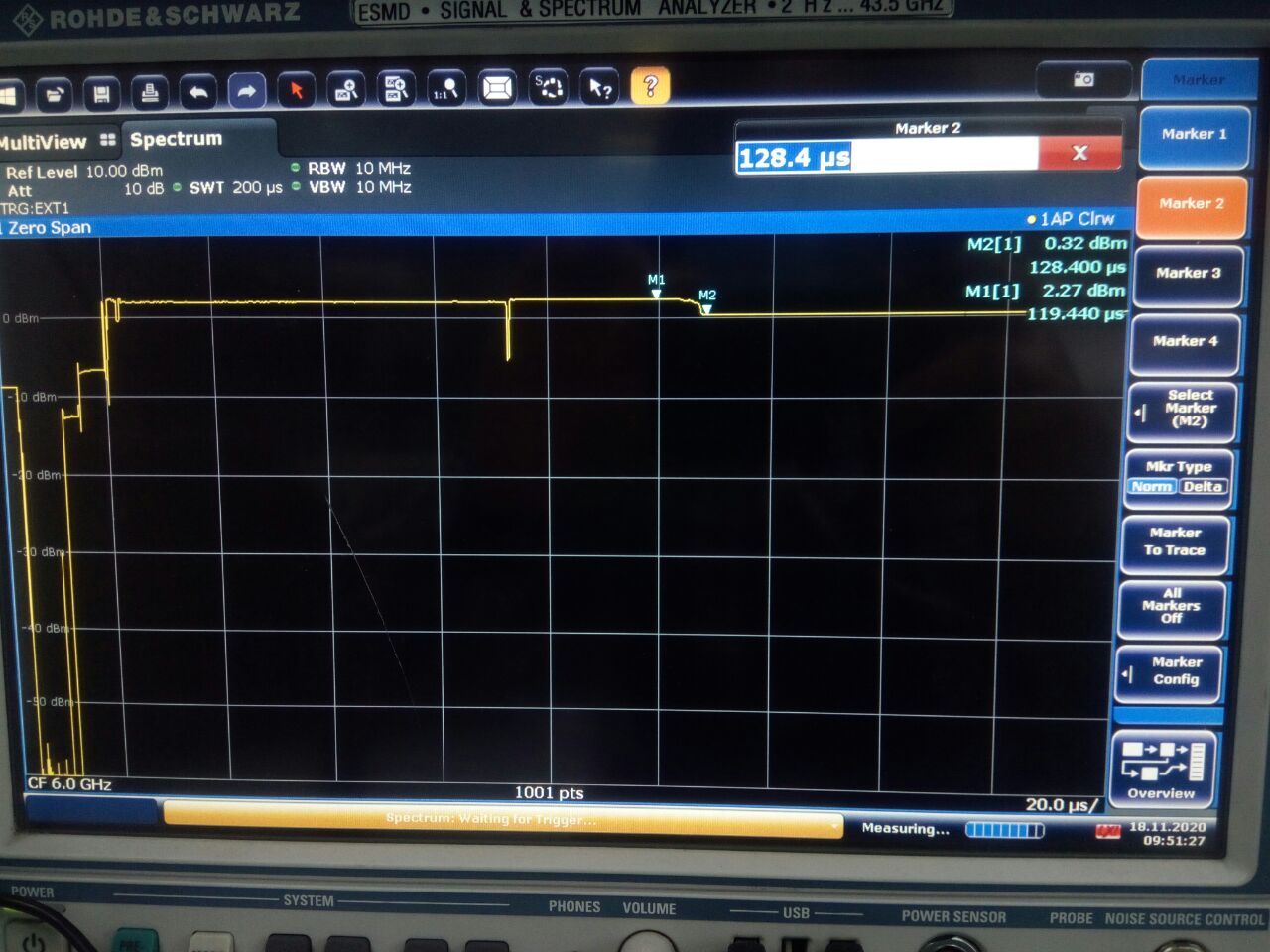

I’m working on the LMX2594, for the sake of shorter lock time, partial assist mode is necessary, and I have some questions about it.
The configuration procedure is as follows (SNAA336):
(The order of configuration is :R8、R7、R6、R5、R4、R3、R2、R1、R0)

The lock time tested as show in the table:
test condition:
(1). trigger: LE falling edge
(2). equipment: frequency analyser
(3). unit: us
(4). fosc: 200MHz
(5). ACAL_CMP_DLY: 20
(6): CAL_CLK_DIV: 0
(7): BW: 375kHz
(8): SPI Programming Speed: 15.625MHz
(9): Fpd: 200MHz
| LMX2594 partial assist, fosc=200M,ACAL_CMP_DLY=20 | |||||||||||||
| 610MHz | 1010MHz | 1510MHz | 2010MHz | 2510MHz | 3010MHz | 3510MHz | 4010MHz | 4510MHz | 5010MHz | 5510MHz | 6010MHz | 6290MHz | |
| 6300MHz | 80 | 66.8 | 120 | 67.2 | 100 | 66 | 68.4 | 67.4 | 127 | 112 | 106 | 71 | 64 |
| 6000MHz | 84.6 | 84 | 85 | 82 | 84 | 81 | 87 | 85 | 84 | 81 | 80 | 81.2 | 80 |
| 5000MHz | 36 | 35 | 38 | 38 | 41 | 33 | 38 | 38 | 36 | 38 | 41 | 36 | 41 |
| 4000MHz | 61 | 48.5 | 84 | 57 | 64 | 46 | 56.5 | 55 | 91 | 74 | 50 | 60 | 46 |
| 3000MHz | 88 | 83 | 86 | 82.4 | 86 | 78 | 86 | 83 | 91 | 84 | 82 | 78 | 78 |
| 2000MHz | 65 | 76 | 68 | 78 | 70 | 60 | 68 | 56 | 65 | 58.5 | 70 | 67 | 59 |
| 1000MHz | 65 | 54 | 93 | 75 | 75 | 68 | 58 | 65 | 65 | 56 | 85 | 63 | 62 |
| 610MHz | 42 | 42 | 42 | 42 | 42 | 42 | 42 | 73 | 43 | 42 | 43 | 43 | |
Here comes the questions.
(1). Is there any improvement with the configuration procedure? Please inform us.
(2). Is the lock time showing in the table the shotest one?
Thanks for advance.
