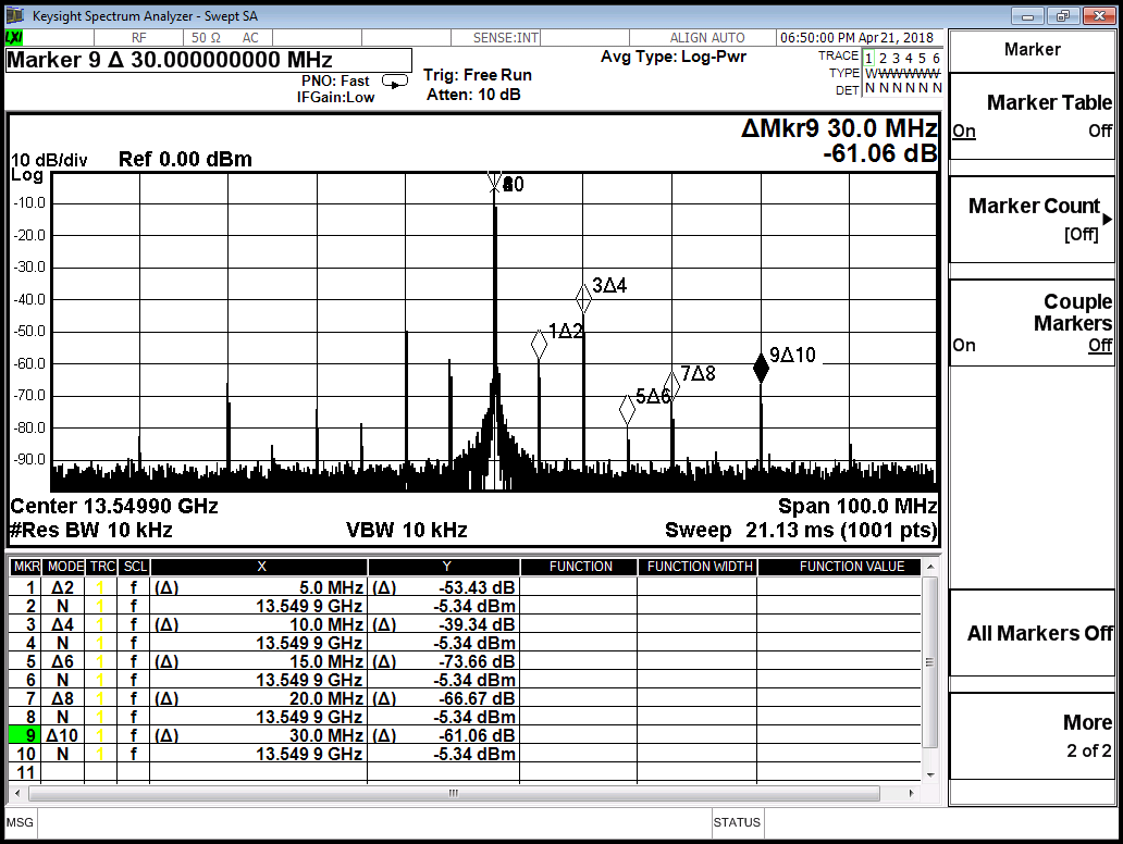

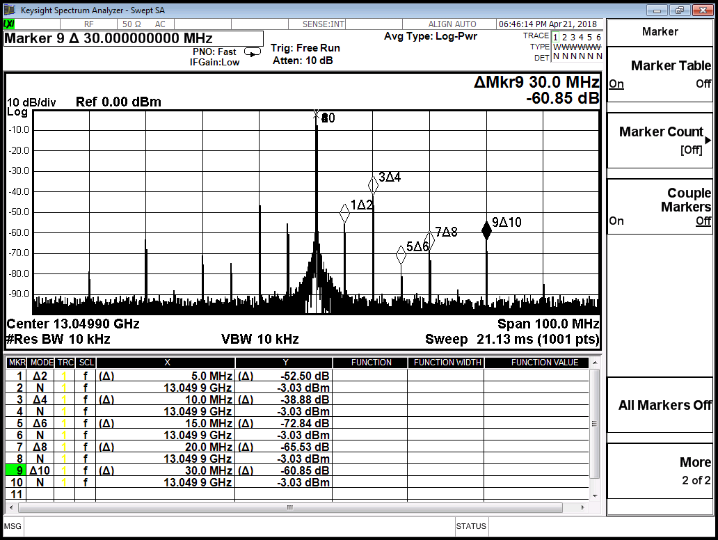

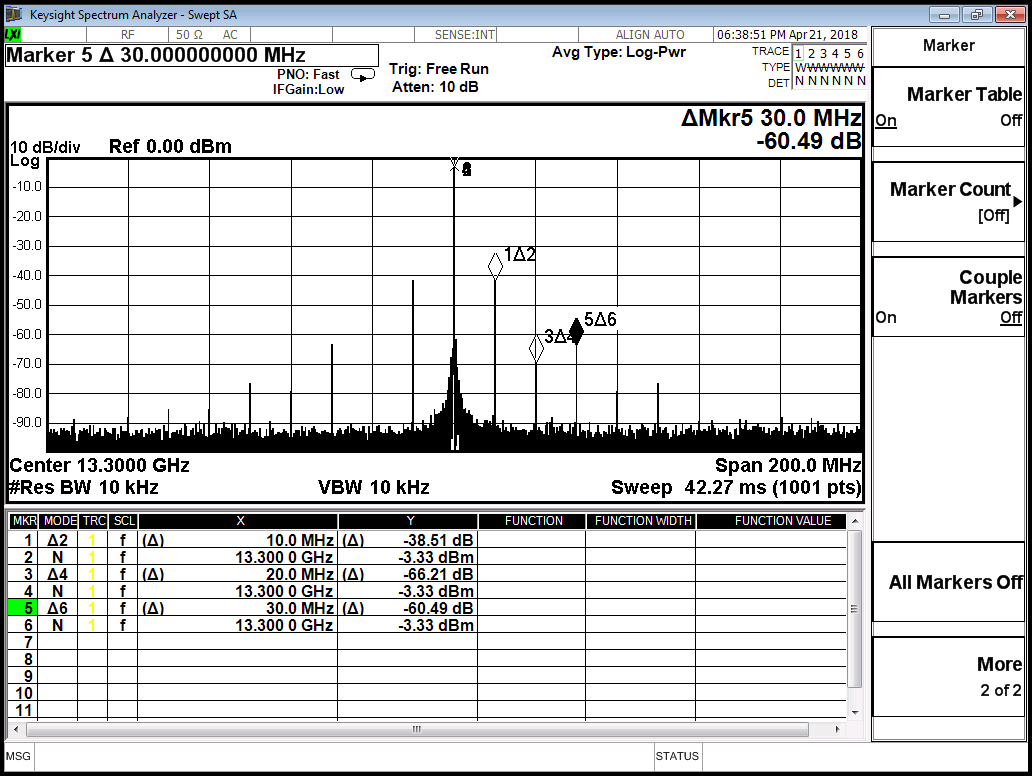

    When using a CMOS source of 10MHz, the phase noise improves but there are additional spurs appearing. I have attached the plots of the spurs at 3 spots 13.05 GHz , 13.3 GHz and 13.55 GHz. Please suggest what can be done to remove these spurs
  • Narenda,
    These spurs look like 10 MHz multiples of your input frequency and the fact that they are impacted by the input suggests they are the Fosc spurs. These are impacted by the input. What the LMX2594 ideally wants to see is low amplitude, differential, high slew rate signal, like LVDS.
    The CMOS has a faster slew rate and this improves phase noise, but I suspect the higher amplitude is causing the spurs. You can do a quick diagnostic of reducing the charge pump current and seeing if the spurs go down. If they do, then you might be able to reduce these with another pole in your loop filter. If they do not (which is what I suspect), this suggests the spurs are going around the loop filter and the biggest thing you can do to impact these spurs is change input format/level/frequency.
