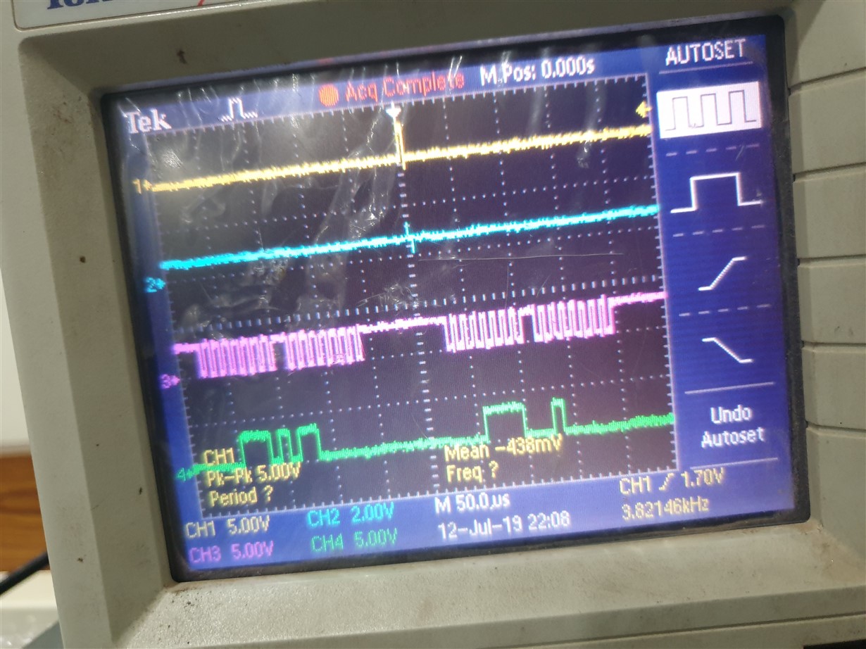

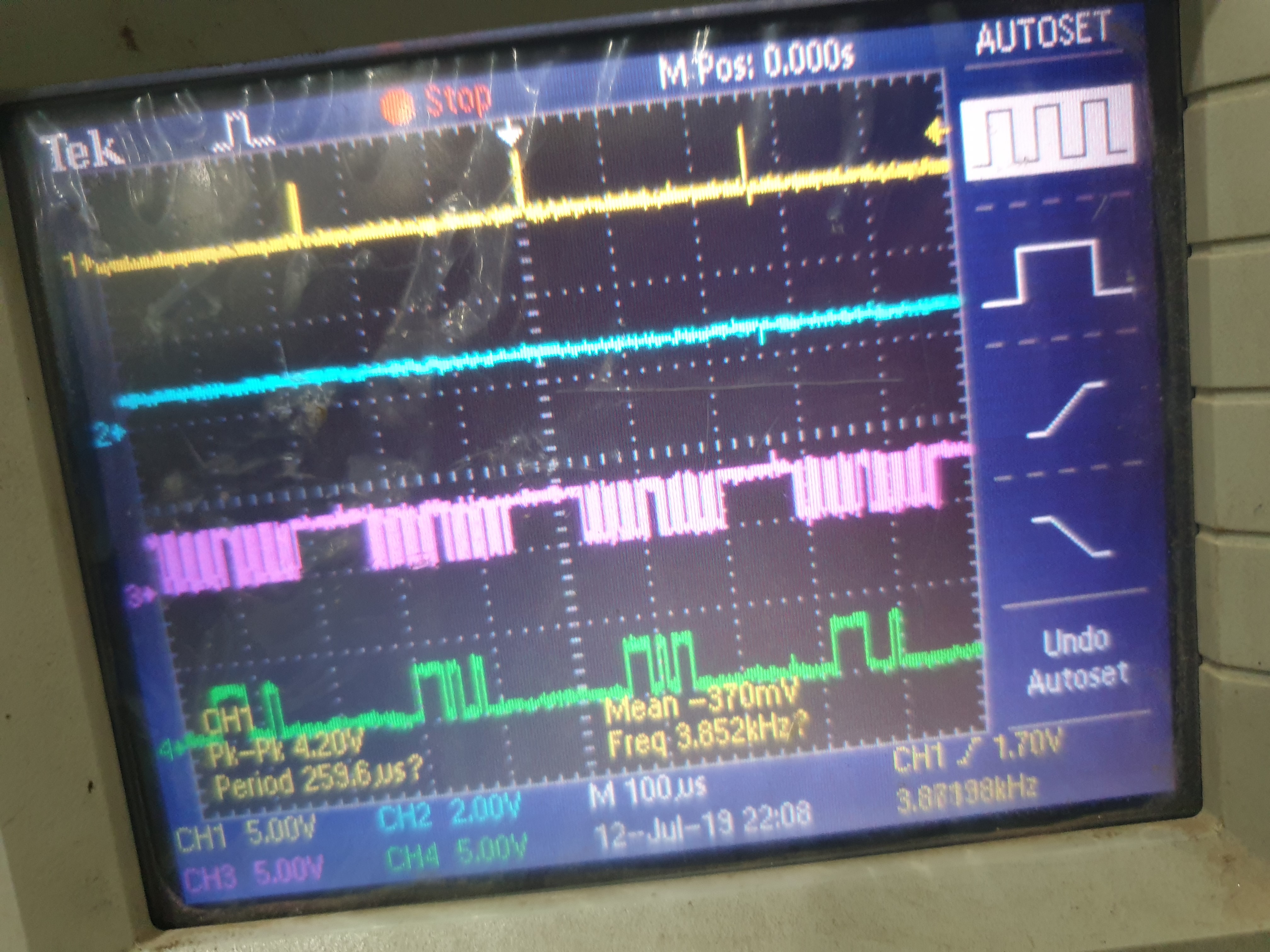

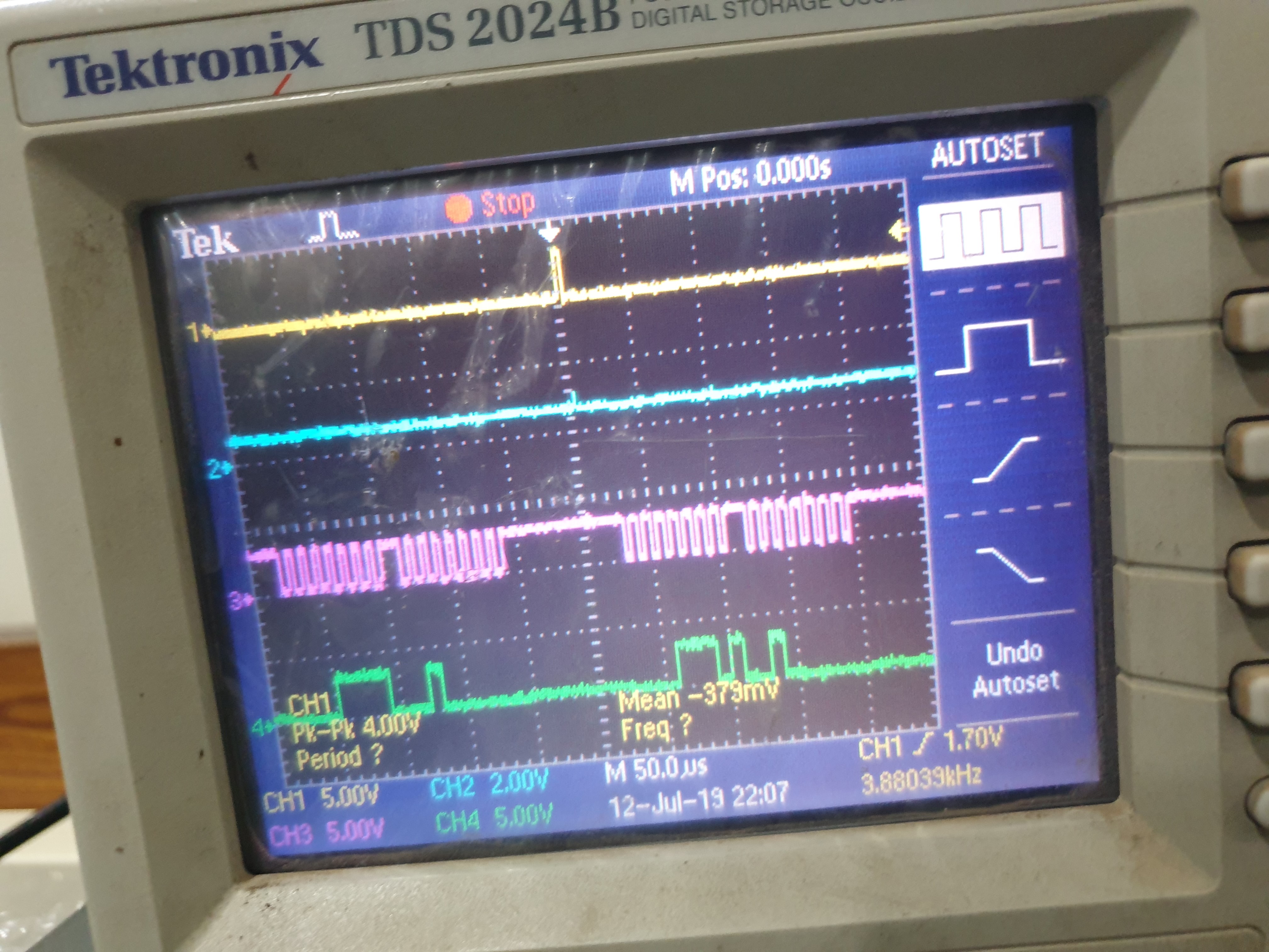

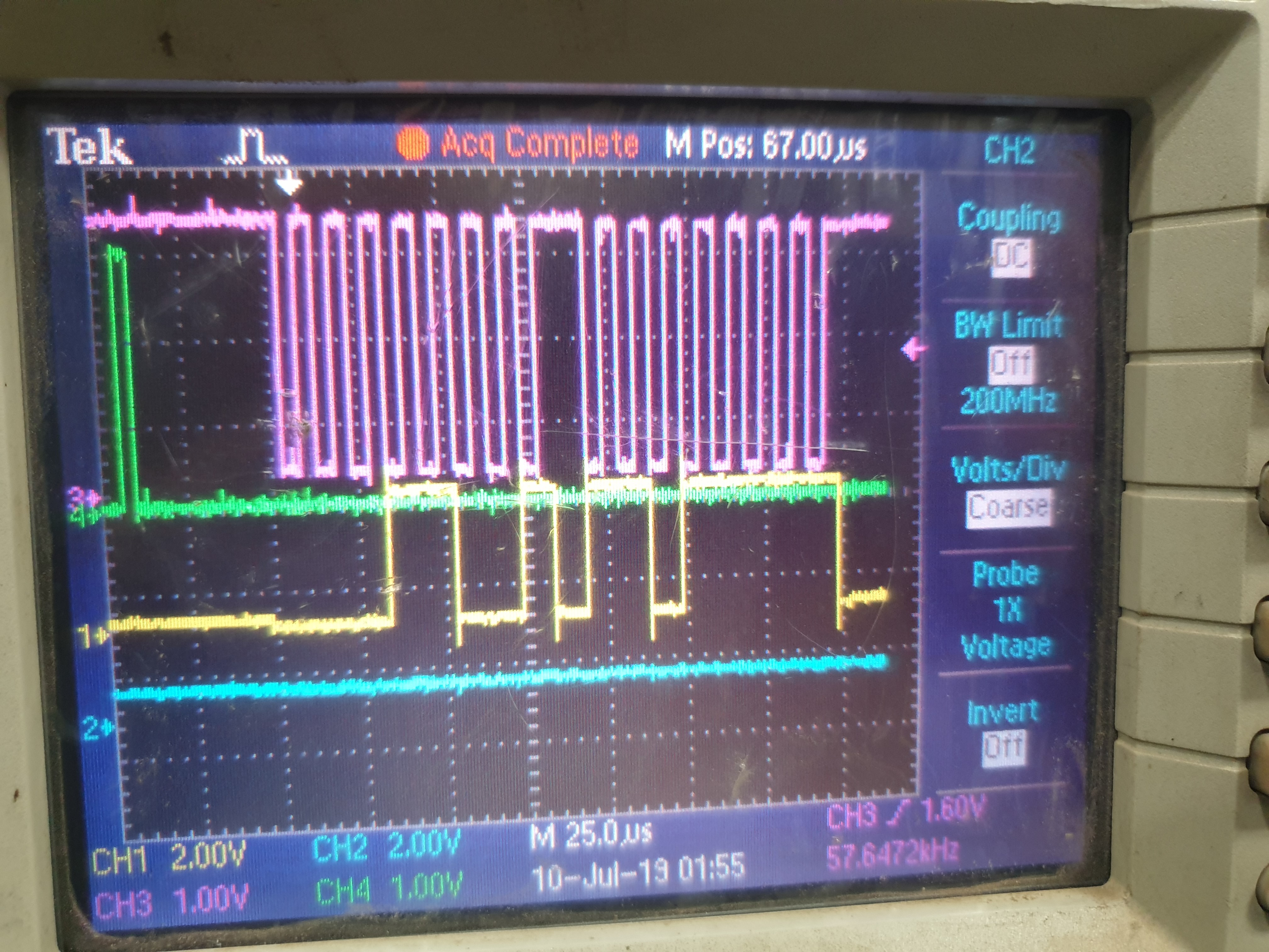

Oscilloscope capture - (CH1 - MOSI - Yellow) (CH2 - MISO - BLUE) (CH3- SCK - PINK) (CH4 - CS# - GREEN)
IMAGE1 - shows only one frame
IMAGE2 - Shows 3 frames
IMAGE3 - Shows two frames in detail.

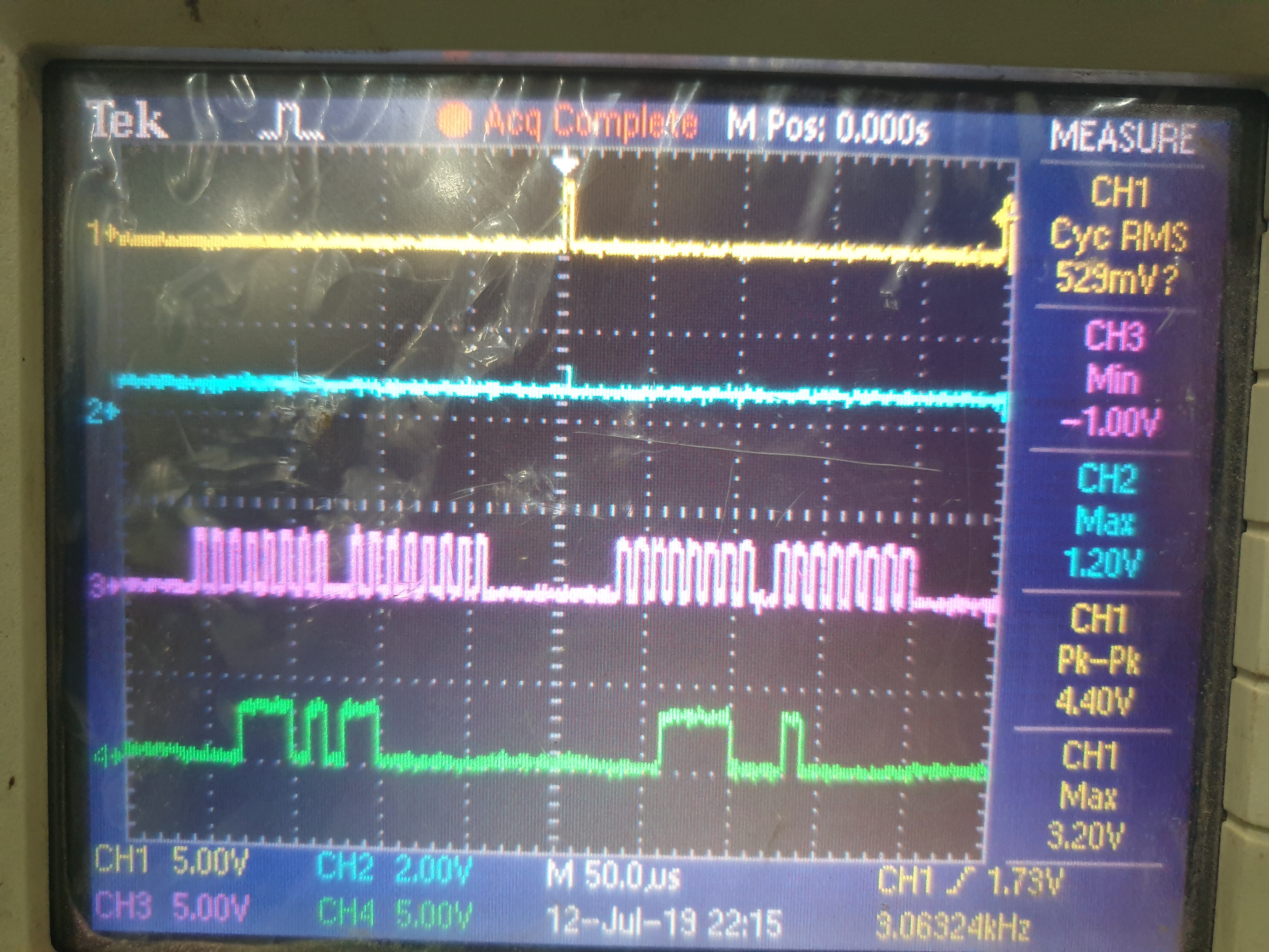

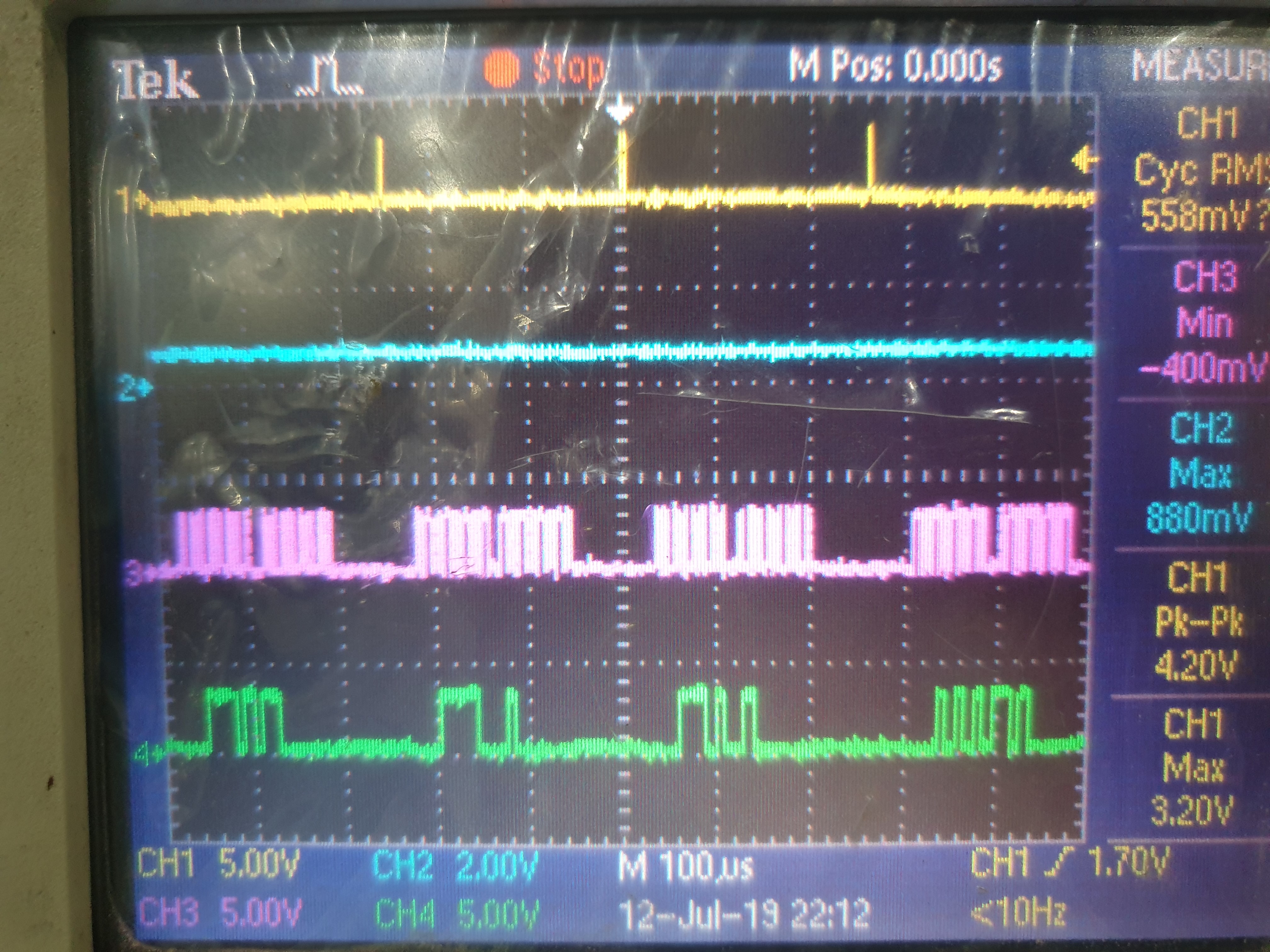

    As per your request I have sent the following command as per your suggesting.
    CH10 and CH12 are 3.3V and CH11 = 4.098V.
    No activity on SDO line. Find the attached image file. I have tested both SPI mode 0 and mode 3.
    (CH1/Yellow/Chip select)
    CH2/Blue/SDO/MISO
    CH3/pink/SCLK
    CH4/Green/SDI/MOSI

    This looks like it is external to the device. The SDO line is being held at a steady voltage above ground.
    Would it be possible to have the SDO pin of the device floating, not connected to anything, including the host? and only monitor it with the oscilloscope, and run the same commands?
    I believe there is something on the board that is holding the SDO line, or perhaps the host itself is causing this.
    Cynthia
  • Dear Cynthia,
    The problem is finally resolved. Sorry the for the late info.
    1. After your input on connecting known voltage to CH10, 11 and 12. I tried to read the ADC, no change on the SDO line of ADC.
    2. We changed the host setup instead of RPI 3b+ board, we connected a SPI port of NXP based development board. The ADC showed the same response.
    3. Finally we changed the ADC (replaced it with new one). Then it worked, no change in circuit.
