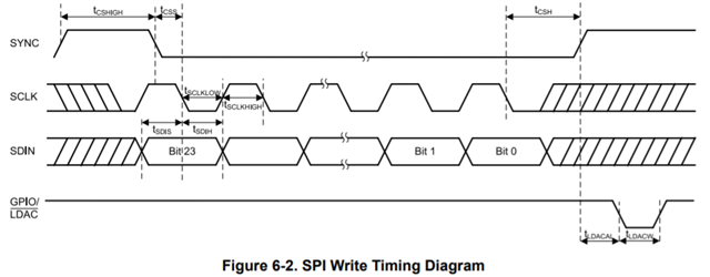

This is from DAC63204/DAC63004 data sheet, page 27: "If the access cycle contains more than the minimum clock edges, only the first 24 bits are used by the device."
Need advise, please.

    Let’s imagine that DAC will receive the 64-bit communication with one /CS, what data bits out of those 64 bits will appear at SDO pin, will there be all 64 bits, or only those that are redundant for the device after it has accepted the command?

  • Hi Pavel,
    I apologize for the delay. I've received a response from the design team on the outstanding questions.
    1. The DAC needs 24*N total bits in daisy chain mode and then the DAC will accept the last 24 bits in the chain. The DAC will expect to get a total of 24*N number of clocks. Any frame with clock count not multiple of 24 will be considered as invalid frame and it will be ignored. With a total of 64 bits, if possible I'd suggest writing an extra 8 bits of dummy data (something that will be considered an invalid input to the ADC) before writing the 24 bits necessary to update the DAC so there is a total of 24*3 bits.
    2. The only difference between the DAC63004 and DAC63204 is the power consumption. They are otherwise functionally the same.

    The data sheet (page 28, paragraph 7.5.1) states following:  .
    • So, it reacts to FIRST 24-bits in the session and don't ignore the frame, which is not aligned to 24 bits.
    • You got from the product designers (I believe) that it reacts to the last 24-bit in the session and wants a frame aligned exactly to N*24 bits.
    So, where is the truth?

    In daisy chain mode the first DAC in the chain should accept the last 24-bits written. The designer let me know that this device supports daisy chain and the device accept the last 24-bits. Let me confirm with the team why the datasheet mentions the opposite. Maybe this is a typo in the datasheet.
    The data is clocked out as described in this section of the DACx1416. The total number of bits needs to be 24*N so the first 24 bits are completely clocked out via the SDO pin of the DAC, and then the remaining 24bits are accepted by the DAC. You can write 8 bits for your ADC, 16 bits of dummy data, then 24 bits for the DAC. The DAC only accepts the last 24 bits of data in it's shift register when CS becomes high, you would send the data meant for your ADC first and it will shift out on the SDO pin of the DAC.
    Katlynne Jones

     So to summarize and to clarify finally.
     The DAC SPI interface wants two conditions to be fulfilled (a logic AND):
    1. The quantity of clocks, associated with a single CS negative pulse, should be an integer multiple of 24. In any other case it will be completely ignored.
    2. The last 24 bits before CS rise will be taken for interpretation as a command by this rising edge of CS.
     Is this correct and were clarified with chip design team?
    Thank you very much
  • Hi Pavel,
    Yes your two points are correct when the device is in daisy chain mode. I heard back about the datasheet confusion, and there should be two sections:
    1. Daisy Chain Mode
      1. Clock count has to be exactly 24*N else the frame is rejected.
      2. Device interprets the last 24 bits of the frame.
    2. Stand-alone mode (this is what's described in the datasheet)
      1. For clock count > 24, first 24 clock are considered and the frame is accepted.
      2. No need for clock count to be multiple of 24 any number >24 is legal.
    Daisy chain mode is enabled when the SDO pin is enabled (SDO_EN bit is set to 1). Thank you for your patience.
