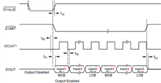

Hi Kengo-san,
Please see the diagram (Figure 22) below for the data output scheme of the DDC112. Both IN1 and IN2 output data need to be serially retrieved from the DOUT with IN2 output data bit followed by the IN1 output data bit. There is no option to specify only a specific channel for retrieval.
-TC
Hi Kengo-san,
The falling edge of /DXMIT in combination with the DCLK will initiate the serial transmission of the data. IN2 channel data will be output first, followed by the IN1 channel data.Thanks
