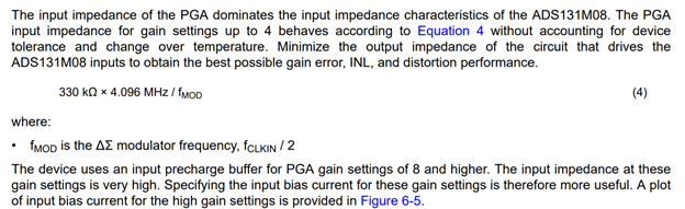

    Could you help to share the input impedance of ADS131M08`s REFIN pin@32kHz data rate? If that works, what`s the maximum output resistance can ADS131M08 accept? and does this decrease performance of ADS131M08?
    In general, the reference is sampled along with the input on every clock cycle so the equation mentioned in the datasheet is the same
    To abstract it a bit more it would be Z_in = R_equivalent * 4.096MHz / f_mod
    However, the equivalent resistance used in the inputs is not the same as the reference so 330-kohm cannot  be used. As you can tell, this number is not specified in the datasheet.
    So, if we agree to go down this path, we need help from the design team to get this answer and it may take weeks to months to get an answer. If you want an answer more quickly, we would need to change the question so that it focuses on the tradeoff that you want. So the question might change to "what magnitude of error will I get specifically using the 1-kohm resistor divider?" which is a more narrow investigation that might not need design's help.
