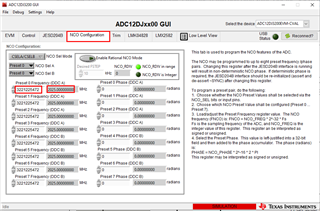

  • Hi Frank1,
    Yes NCO can be configured through the GUI. The setting are under NCO Configuration Tab. As shown in the Figure below. By Preset 0 Frequency the NCO frequency can be updated.
