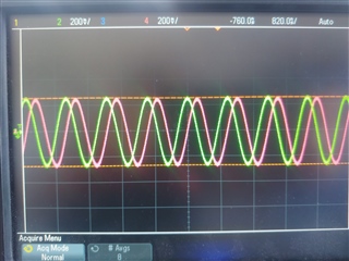

To see if I can obtain the output from the DAC and the SYSREF from the LMK, I tried to perform the NCO TEST and once I configured the output level from the SIF, the MIXER frequencies and send a SYSREF pulse I can obtain the sinusoids that I expect.

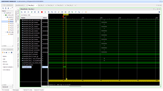

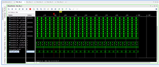

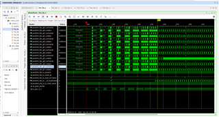

    The only way I was able to see something is to lower the lane rate from 10 Gbps to 5 Gbps. I supposed the motherboard doesn't support a high bit rate. So I did a new vivado design by setting the lane rate at 5 Gbps.
    -- after sending a SYSREF pulse I noticed a periodic behaviour on the SYNC signal
    and the DAC outputs were showing something
    So as it is possible to observe both in Vivado and in the oscilloscope there is a periodic signal. So the oscilloscope was showing what the FPGA was sending. At this point, I activated my waveform generator on FPGA and I obtained what I expected.
    I'm able to replicate this behaviour but I have to: activate the DAC PLL,  bypass the ILA sequence on the tx side and set the 0x4F register to 0x1CE1. The SYSREF is a pulse sequence at freq of 7.8125 MHz. I'm not able to replicate this at 10 Gbps.
