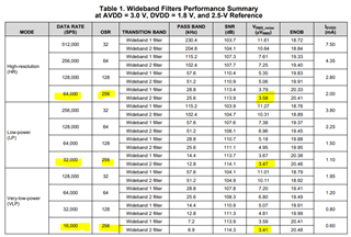

With the HR pin tied low, when converting the EXT terminal external resistance from 120K to 60.4K, that is, when switching VLP mode to LP mode, it does get higher in power consumption, but the output noise of the ADC is not improved.
But at this point the AFE front end equivalent self-noise and the theoretical output noise of the ADC are essentially equal, so the overall equivalent self-noise output should be somewhat reduced after switching mode.
The customer would like to know what's the possible reason for that. Thanks!

    Switching REXT from 120k to 60k has very little impact on the total noise in the ADC.  It does slightly reduce the noise in the internal amplifiers, but the thermal noise from other internal components dominate the total ADC noise.  The purpose of increasing power (reducing REXT) is to support higher input clock frequency and higher output data rates.  Decreasing REXT increases the internal amplifier bandwidth which results in shorter settling times needed to support higher output data rates.
    The maximum Fclk in VLP mode is 4.4MHz.  Reducing REXT to 60.4k (increasing total power) allows Fclk to increase up to 8.8MHz.  For the same OSR setting, you can now operate at 2x the output data rate.
    Table 1 in the datasheet confirms that the noise does not change for the different power modes; it mostly depends on the OSR setting.  For example, OSR=256, WB2 filter, in all cases, the noise is approximately equal to 3.5uVrms (there is some variation as Fclk increases).

    The customer would like to confirm the following info:
    1. OSR is the main determinant of ADC output noise.  If the same FCLK is used, is it not possible to improve the output noise of the ADC through mode conversion of VLP-LP-HR?
    2. If the customer would like  to get lower ADC noise at the same sampling frequency, change the OSR accordingly after changing the FCLK according to the figure you given, is that right?
    Thanks again!
    Cherry
  • Hi Cherry,
    1.  Yes, that is correct.  The internal noise of the ADS127L01 does not improve when using the different modes for the same FCLK, OSR, and Filter setting.  Operating Fclk at a lower frequency does allow more time for the external reference and amplifier to settle, so it may improve the overall noise due to external components, but it will not improve the noise of the ADC.
    2.  Yes, the lowest noise for the ADS127L01 is when using the highest OSR setting.  For example, using Wideband filter 2 and output data rate of 64ksps, you can either operate in HR mode with OSR=256 and Fclk=16.384MHz (SNR=113.9dB), OR, operate in VLP mode with OSR=64 and Fclk=4.096MHz (SNR=108.3dB).
