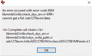

I have been trying to collect some data from ADCpro1278 via ADCpro software tool installed in laptop and facing issue in acquiring stage (i.e when I hit the button on acquire).
The issue is whenever, I plug in USB cable to laptop  - (at first in device manager it shows NI-VISA and then --> USB-styx --> suddenly at some point it disappear soon) and when I trying to start acquiring the data it throws an error below.
So far from the error code,this tips I found out from the TI forum answer given by Andrew check this post ((+) ADS1278: Timeout errors when connecting EVM to ADCpro - Data converters forum - Data converters - TI E2E support forums).
I felt that it might be a driver problem and I tried to solve it via doing some steps mentioned here (only first one tried so far - Top 2 Ways to Disable Driver Signature Enforcement on Windows 10/8.1/8/7/XP/Vista | Driver Talent (drivethelife.com) but did not worked.
So my question will be what can be done in this situation ? Is something wrong with my driver if yes then how should I update? if it's driver related problem. If not then any suggestion will be appreciated :-)

    I have followed your instruction carefully (i.e, re-install drivers and ADCpro software from scratch) --> it worked only the first time (one time), and then when I try again connecting them and acquiring the data, it throws a bunch of errors (different error while doing multiple times - even doing the same thing, for example, taking out the USB and putting back and starting to do again and so on).
    What could be the reason for the attached errors? and why?
  • Hi Vikas,
    It appears that the USB-Styx driver is no longer installed.  Can you confirm that it is not installed correctly under 'Device Manager'?
    If it shows up as unknown device, you can follow these steps and manually re-install the driver.  You will want to leave the EVM connected to the USB port so you can manually install the driver.  Once it is installed, disconnect the EVM (and remove power), then reconnect everything.  Hopefully, it should now work!

  • Hello Vikas,
    There is one other possibility.  You had mentioned that the EVM will initially work, but then at some point, it stops working.  If the power to the EVM is temporarily interrupted, the USBstyx driver will stop working, and you will get the 6004 error, which indicates the driver is no longer working.
    Please verify your external supply is set to the appropriate values:
