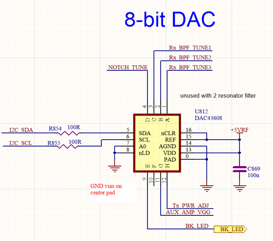

I'm having issue with this part. When talking to the DAC with low speed (<70kHz), it seems to be working OK, but having some problems at normal (100kHz) and fast speed (400kHz).
Schematic and layout looks OK to me, but I wonder if I'm missing anything here, maybe a bad config, etc. Component and board looks okay on the microscope.

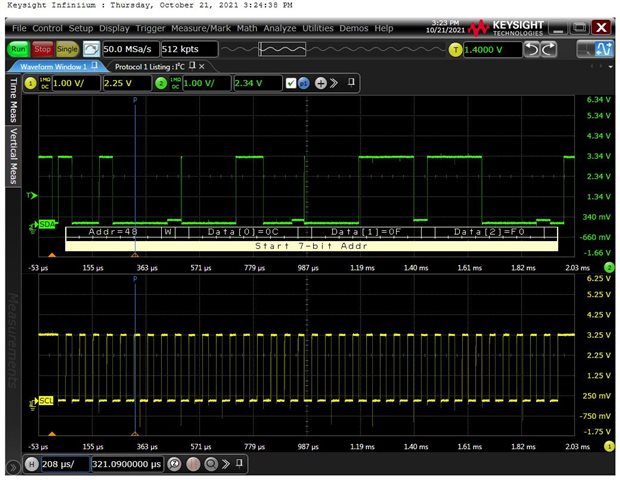

    Can you scare an oscilloscope shot of the I2C lines at the low speed where you have successful communication, and at a higher speed? Also, what is the value of the I2C pullup resistors? I do not se them in your schematic.

    This is how it looks like at 100kHz. The plot at 20kHz looks similar, .
    Our firmware engineer managed to find out there's a short delay sequence that wasn't immediately obvious that actually allows the DAC to operate correctly now. I wonder if this information was in datasheet, or perhaps I might have missed this information. Thanks!
    Pull up to 3V3
    I'm glad you and your team were able to solve the issue. There are a few required delays according to the timing requirements table:
    I wonder if you are referring to tbuf, which is the time SDA needs to be free between start and stop conditions.
