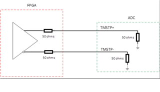

Hi Frank1,
I would recommend to either use the 1.8V HSTL or SSTL standard IO on the FPGA. Generally the FPGA has internal series 50ohms resistors and the ADC also has 50 Ohms to ground for each leg when TMSTP_LVPECL_EN = 1. So in theory the circuit shown below should work and there shouldn’t be a need to add any component . If the FPGA does not have the Series 50ohms inside the FPGA you can add them on the board on each line.

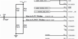

Hi Neeraj,
Thank you for your response.
Well our implementation is a little different.
We have an original design that we would like to change.
The input is a single eded analog signal from an RFoF and AC coupled. Which means that we only get a pulse on the input.
And in datasheet is states that the inputs (TMSTP) must be externally biased.
Any recommendations on the biasing?
Thanks.
Hi Frank1,
They way you have biased TMSTP looks ok to me. Do you want to the signal on TMSTP pins to differential or just single ended?
Neeraj
Hi Neeraj,
1) We would like to bias using 1.1V or 1.9V instead since 3.3V carry noise into the ADC.
2) The input signal is just a single ended pulse (1PPS) which means that when the pulse dies out (due to AC coupling) the inputs to the ADC will only see the difference in bias (0.096V) which is less that the specified 0.4V diff requirement for the ADC.
Will this work then?
Thank you.
Hi Frank1,
Yes, you can bias using 1.1V or 1.9V.
Yes, I think you proposal should work.
