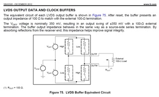

Howdy,
As per the ADS5263 datasheet, specifically Register Address 12 shown on page 49, the Data, ADCLK, and LCLK LVDS outputs have programmable terminations.  Is there an LVDS output buffer circuit diagram showing these terminations?  In reading past ADS5263 posts I'm thinking that it may be the same as, or similar to, the circuit shown in Figure 75 of the ADS5295 ADC datasheet (figure shown below).  Any information on the these output terminations would be greatly appreciated.
Mick S.
