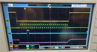

    the screen shot you provided is the first frame needed to read a register, in your case you are reading the high threshold for channel 0. But, you are missing the second frame where the register data will be outputted. The register data will not be outputted in this same frame.
    As for a read test, I suggest not reconfiguring all the channel. you can simply read a known register, such as the System status register.

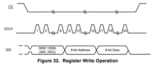

  • you are not counting your clock cycle correctly, you are starting off wrong. one clock cycle should be considered as falling edge to falling edge. in the first clock cycle, the CS falling frame can be considered as the first SCLK, and the first frame then ends with the falling edge, where you currently have part of sclk pulse 2.
    this means you likely will need to move your commands over one clock cycle.
    Note the clock numeration in the below image

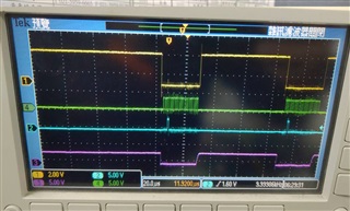

    After reading F2806x TRM(https://www.ti.com/lit/ug/spruh18h/spruh18h.pdf?ts=1639448638768) for a while, I found this figure.
    This figure shows the mode of SPI-00 (Rising edge without delay) change states on the rising edge and latch data on the falling edge of SCLK, which makes me a little confused with your previous reply.
    SO, I tried two modes and the screenshots are shown below.
    And the ADS7038Q1EVM-PDK I bought last week has arrived
    I use a logic analyzer to monitor its frame, results as shown in the figure below.
    It seems to be different from the above two tests.
    I will try to set the SPI to “Rising edge with delay”, which is the most similar to the package of the development board.
  • In the two test you performed, both will not work with the device in mode 0. The first test, you are still using the wrong edges. You should be "reading" or latching the data on the rising edge of SCLK. Data should change states on the falling edge of SCLK. you are doing the opposite
    The second test, you are using the wrong clock polarity. the clock should be low when idle.
    The logic analyzer shows the SDO data changing states on the falling edge. Also note that the logic analyzer will use the user-configured mode to read data, it does not know automatically what mode to use. This is a user configuration. From the logic analyzer, you can see that clock polarity is low (0) coming from the EVM, thus your test 2 will not work with the device in Mode 0.
    To properly communicate with the device and read data as expected, the Clock should be low when idle, latch the data on the rising edge of SCLK., change states on the falling edge of SCLK. and use falling edges to count clock cycles.  This would be "rising edge with delay" in the snippet you shared.
