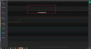

    Step 1: Data ready is sending the pulse. The pulse rate is 10 samples/sec. This seems right.
    Step 2: This is where I am stuck. The readings are always 255 255 255. My multi meter responds to changes in force and give a voltage reading. I would think I should at least observe one or two bits  change from high to low.

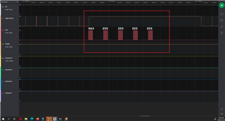

    Thanks for the logic analyzer data.  It shows you retrieved 63d 255d 255d.  It is easiest to show these values as hex and assemble and calculate the output voltage.  In hex we see the value as 3F FF FFh or 4194303d.  This would be close to positive mid-scale.  So in short, the first 3 bytes returned is the data.  Byte 4 forces DRDY/DOUT high and initiates an offset calibration.  Byte 5 is unnecessary and does nothing.  The data returned in bytes 4 and 5 are not conversion results and have no specific meaning.

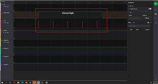

  • Hi Bob,
    Thank you for your reply. I have connected all the digital pins to either ground or PWR as described in the datasheet.

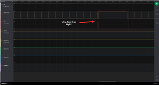

    What I am concerned about is not the actual reading at this point in time. What I am concerned about is why I do not see any bits switching to low. When the CLK signal is sent the readings are always high. The reason the 1st byte is 0x7F is probably because the reader is calculating the instance the DRDY is going from a low/high pulse to a high state. After which it remains at high.
    This does not look correct. I do not need to interpret the numbers if there is not a single bit that is changing state. Basic observation seems to tell me something is not right.
    What  can I physically do to see one bit change? Any recommended troubleshooting options.
    Thank you so much.
    Note: The above reply I might have confused you. The red is the CLK and the brown is the data. I put the labels of 063 255 255 over the clock data. It should have been over the DRDY data.
  • Hi Anthony,
    Can you send me a more detailed view of the first byte?  Perhaps you can attach the .sal file of the collected data.  What is your input voltage so we can determine the expected output response?
    Make sure you understand how the device operates.  When the DRDY/DOUT transitions from a high-to-low state, this is the signal that the ADS1234 has data to convert.  You must completely read the conversion result before the next conversion cycle completes.  The conversion data itself is 3 bytes.  If you send additional clocks, clock 25 forces DRDY/DOUT high and clock 26 forces an offset calibration.  See Table 8-9 and Figure 8-11.  Note that at the 10sps data output rate the offset calibration takes about 810ms (holding DRDY/DOUT high the entire time) before a valid conversion is available.  If you continue to send SCLKs you are most likely adding additional offset calibrations.  I would suggest initially only clocking 3 bytes and collecting just the data to see if this will affect the outcome.

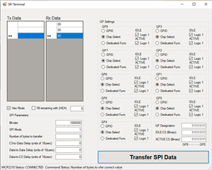

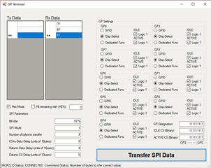

  • Sure. The voltage is 5V. Both for DVDD and AVDD. I am controlling my signals from the SPI terminal using the  microchip mcp2210.
    I cannot seem to upload a .sal file extension. You can download the file from this link: https://drive.google.com/file/d/1B8Mua2OzWyXdWhTPQBbB1j7K3u4SzVDv/view?usp=sharing
    Thank you so much.
  • Hi Anthony,
    Thanks for trying. Unfortunately TI does not allow us to access shared drives like Google drive for security reasons.  So I guess we will have to go back and capture screen shots.
    I noticed that the SPI mode is set to 0.  You should be using SPI mode 1 where clock idles low, data changes on rising edge and holds steady on the falling edge.
    I also think you are seeing positive full-scale in this case.  Make sure that your input voltage is within measurement range and that you have a valid reference voltage connected to the reference inputs.  To check your input voltage measure this in 2 ways.  First measure across the the two input pins.  This should be the voltage reported back by the conversion result.  Second, measure each pin separately relative to ground.  These voltages must be within AVDD-1.5V and AGND + 1.5V unless a gain of 1 or 2 is used.  If the lower gains are used than the input voltage must be within AVDD and AGND.

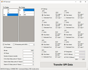

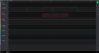

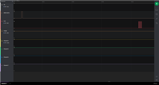

  • Hi Bob,
    Thank you for your help again. the SPI mode 1 seems to give me a better response.
    Now I get all zeros.
    Zoomed out version:
    Zoomed in version:
    Signal I am sending:
    The voltage reading by the + and - seems to be well within range.  I am measuring 0.13 volts across the load cell's + -  which is also connected to the + - of channel 1.
  • Hi Anthony,
    Prototyping can be a difficult task for a number of reasons.  One common problem is the white breadboard where the wires can work loose.  The top picture appears to be one of those cases where either the gain or address pins changes state which will restart the conversion.
    For a load cell you should be using a gain of 128 where both gain pins are pulled high.  I would also expect that you would see noise even at a gain of 1.  Verify that the load cell connections are set to the address selected.  If A0 and A1 are both low, you should be connected to the pins 11 (AINP1) and 12 AINN1).
    Bob B

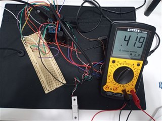

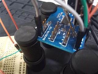

    I have been troubleshooting whole day (clearly horrible at this) and I did find a few soldering issues. My craftsmanship was not good. Especially the gain pins were floating. I believe now that is fixed.
    I am moving slightly ahead now.
    I have now connected:
    A0 and A1 to the 5V rail to use channel 4
    Gains too are connected to 5V rail to use 128
    The readings are Rx 7F BF FF
    I am not sure if these readings make sense or not
    What I am observing is my multi meter is averaging at .419 Volts. Depending on the direction I push the load cells the readings read .418V to .421V
    What would the 24 bit 2's compliment of this be? The multi-meter is positioned on the side of the  resistor connected to the I.C pins.
    Thank you for your help. Next time, I rather get a stencil and solder using a hotplate. Oh well.
    Anthony
  • Hi Anthony,
    From the logic analyzer shot it would appear that the data rate is now 80sps instead of 10sps (SPEED pin set high).  So you are not actually capturing all of the data between conversions.  You can speed up your SPI SCLK to see if you can capture the complete data.
    Based on GAIN of 128 and your input voltage my guess is you are actually getting positive full-scale (0x7F FF FF).  The next conversion update is actually mixing the two conversions together.
    Also, I think you have your load cell miswired.  Load cell should have close to 0V output with no load.  Most load cells also have a sensitivity of 1 to 3mV/V output.  So with 5V excitation the full scale output would be in the range of 5 to 15mV.  419mV is way too high.

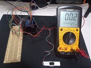

    Yes, I realized after I posted that I was sampling at 80 Samples/sec. I have connected the speed to ground now.
    There is something strange with the ADS1234 I currently observe.

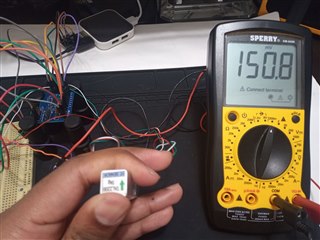

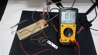

    By default, With no connections to the ADS1234 my loadcell by default reads 0.2mV. This seem normal.
    When I apply some force, it changes accordingly.
    Nothing in here seems too off.

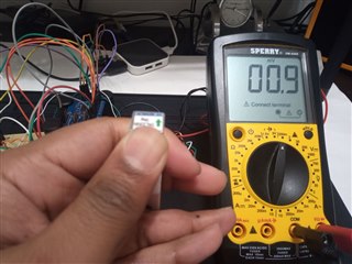

    When I connect the loadcell to the ADS1234 and enable the PDOWN pin to high, the voltage jumps. No force readings
    With force
    Why is there a voltage suddenly applied? When I change the gain to different configuration the voltage changes.
    Is this normal?
    Thank you.
  • Hi Anthony,
    I have a little trouble with checking your wiring, but most likely there is a voltage that is being back driven through the ADC inputs.  Double check that your voltages are connected properly.  Another possibility is the device got damaged.  Try a different set of inputs to see if you have the same issues.
