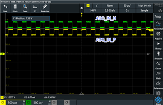

  • Hi Rob,
    When I changed the Internal DLL, the problem was fixed.
    But after a while he has the same problem again.
    I have attached the circuit diagram and oscilloscope images of the voltages applied to its analog inputs.
    Best regards.
    Ahmet

  • Hi Ahmet,
    The internal DLL should be off when sampling at 25MSPS.
    Would it be possible to share the amplifier part number in the schematic above? I can't make out the number.
    Also, can you please also measure the DC voltage on the analog inputs? Both and P and N inputs should be +1.55V.
    Rob
  • Hi Rob,
    The amplifier part code is AD8132ARMZ.
    Both P and N input voltages are 1.55 volts relative to GND.
    We apply a differential voltage both the P and N inputs. (min:1.15volt, max:2.95volt relative to GND)
    I shared the oscilloscope outputs in my previous reply.
    CLKP and CLKM inputs are provided differentially by FPGA. The pulse amplitude is 3.3 volts. Will this pose a problem?

  • Hi Ahmet,
    I think it might be best to send a few output plots from the ADC in either time domain or frequency domain, FFT.
    I would be best to show with and without an input signal applied.
    If you can forward a better picture of your schematic above that might help too. The picture supplied previously is to fuzzy to make out the details of the circuit.
    Rob
  • Hi Rob,
    I have shared the pictures below.
    I have also attached the circuit schematic as a pdf file.
    Ahmet

  • Hi Ahmet,
    Thanks for the plots and schematic. The output looks fine to me. Your oscope BW or probe on the oscilloscope is probably limiting the transition time it takes for D0 to go high and low.
    I am really more interested in output representation you are capturing?
    Are you trying to reconstruct a signal? If so, I would like to see that output? Is it not what you expect?
    Also, what is the frequency or speed of the analog input signal?
    Rob
