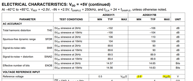

My customer is considering ADS8317 and he has one question.
He wants to use it with Vdd = 5.0V±5% and Vref = 2.5V.
Datasheet says recommended Vref range is 0.5V~Vdd/2 when VDD is 5V.
Can Vref=2.5V be used when VDD is 4.75V(5.0V-5%)? Since Vdd/2 will be 2.375V, which is smaller than 2.5V.
Or when VDD is 4.75V, the Vref(max) will just be 2.375V rather than 2.5V?
Thanks.
Jo
