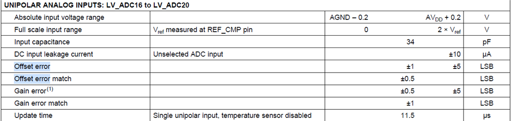

    3. Sometimes I can see the datasheet shown with offset error and offset error match. What is the difference between them? Like shown in AMC7836 datasheet as below.

    3. Offset Error Matching should be the channel-to-channel matching of the offset error.
