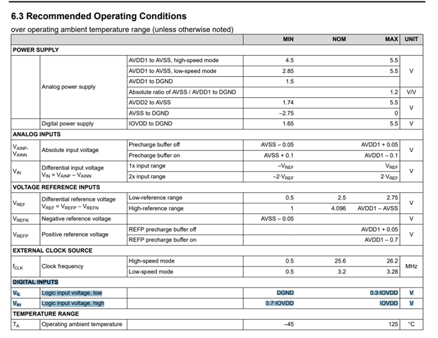

Hi team,
How much is the digital input threshold voltage?
I can only see the data below in the datasheet.
What will the logic become when input 0.3*IOVDD~0.7*IOVDD?

Hi Yuto,
The digital input thresholds are defined by your IOVDD supply voltage. For example if IOVDD is 5V then your input LOW threshold (VIL) will be a maximum of 0.3 * IOVDD = 1.5V and your input HIGH threshold (VIH) will be a minimum of 0.7 * IOVDD = 3.5V.
This means that you need to ensure your digital inputs will be provided a signal that is 1.5V or below to indicate a Logic LOW and 3.5V or above for a Logic HIGH for an IOVDD = 5V. Otherwise, you will be in a undefined logic state where the logic level can be either HIGH or LOW.
Anyone from the ADC team, feel free to correct me if I am wrong. Thanks!
