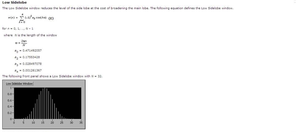

    Background: in order to use this part in our design, I modeled its function to simulate and predict certain performances. However, my model was not consistent at recreating information in the data sheet UNLESS I made certain assumptions regarding the methodology of generating the Output Spectral Plots.
    How EXACTLY are the Output Spectrum Plots, as shown in Figures 1-6 on page 7 of ADS1282 data sheet, generated?

  • From your description, you have verified that the 31.25 Hz is not synchronized to the ADC at all.
    What are the EXACT coefficients used in the "Low Sidelobe Window" function? Can you locate the exact weighting function used to create the curves in the data sheet?
    BACKGROUND: To prevent excessive sidelobe generation from an FFT of an asynchronous pure tone signal, a weighting window is applied to the data before the FFT is calculated. In this case the window function consists of 8192 coefficients that are multiplied times the 8192 data points with the products used to calculate the FFT. Shape of the window function greatly impacts the results. Two, often used weighting functions, are hamming window and hanning window. Hanning [to me] is preferable. The hanning window is similar to the well-knwon hamming window. It is also an offset single cosine window. However, with the hanning window the weighting function starts at zero, goes to a peak in the center of 2, and back down to zero following the cosine curve. The peak of 2 is used to keep the average signal information normalized, maintaining proper amplitude of the resulting FFT.

  • Hello Frank,
    The differential amplifier (OPA1632) on the ADS1282EVM set up is mainly used to keep the common mode voltage constant.  This is in order to not have common -mode rejection errors on the measurements.  Since the ADS1282 device already has a built in PGA to drive the Delta-Digma modulator, the primary function is only to set the common mode voltage when the Audio Precision signal generator is connected to the device.
    The FFT 8192 point FFT plots where generated using the "Low-Sidelobe" FFT Window function built into the Lab View software package.  The Low Sidelobe function was chosen since it provides the best rejection at the side lobe at the cost of broadening the main lobe.  This window function is similar to the Blackman-Harris.
    Below is a section from the Lab View help file that shows some of the coefficients of the Low Sidelobe function.  I noticed that "a1" coefficient is missing on the description and I suspect this is a typo on the help file.  Attached is also a PDF file with the complete Lab View help  regarding the "Characteristics of Different Smoothing Windows" in the Lab View help menu.
    I hope this helps.
    Luis
