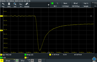

I'm trying to sample repeating signals with the AFE and TX810 T/R switch.
I'm turning on the TR switch 50uSec before transmitting a pulse
using scope I have verify that the sampled signal is consistent ,
after analyzing the data I have found 5% error from pulse to pulse ,
after more testing I have found that the cause to the problem comes from the TR switch - TX810,
see picture attached:
With the TR always on the samples was consistent.
what can i do the get a consistent signal to the AFE from the TR switch?
see schematics below :
