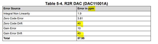

May I know how to get the Zero code drift and Gain Error drift?
Error Calculation for Unbuffered R2R DAC – Example Using DAC11001A (Rev. A)

That would be the Zero code error temperature coefficient and Gain error temperature coefficient. Here is a screenshot from the DAC11001A datasheet. You can see that the temperature drift is given in ppm FSR/C:
The DAC80501 gives the zero code error drift in uV/C and the gain error drift in ppm FSR/C. Make sure you translate everything into the same units before summing the errors.

This way. Please help convert the ±0.04 ppm FSR/°C to 40 ppm.
From the datasheet temperature coefficient of ±0.04 ppm FSR/°C
We will get 40 ppm
You said that "Zero code drift" and "Gain error drift" is coming from the "Zero code error temperature coefficient" and "Gain error temperature coefficient" respectively.

Typically you just multiply the drift by the temperature range of interest as shown in this portion of the article:
But I am not able to get the same value as shown in the table when I use that equation. I need to check with the author of this article to see what values they used to calculate the 40ppm given in the table. I'll let you know when I hear back from them.

Here is their explanation:
Gain error drift spec is ±0.04ppm FSR/degC
FSR = 10V, so drift = ±0.4 ppm/C
Operating temperature range = -40 to +125 C
Drift Error in ppm = ±0.4 ppm/C x Max operating temperature range , where
Max Operating temp range = Max { abs [T high - 25 ] , abs [ Tlow – 25 ] }, assuming calibration is performed only at 25 C
So Max operating temp range = Max [ abs(125-25) , abs (-40-25) ] = Max [ 100, 65] = 100 C
Gain error drift in ppm = ±0.4 x 100 = 40 ppm
