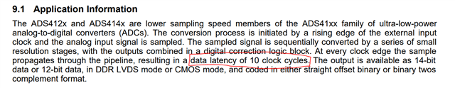

    Also keep in mind that this ADC is a pipeline architecture. Therefore, any interrupt in the sampling process will cause delay and the pipe needs to flush 10 clock cycles before the next valid sample can be acquired on the output.
    Also, see the section 9.1 in the datasheet.
