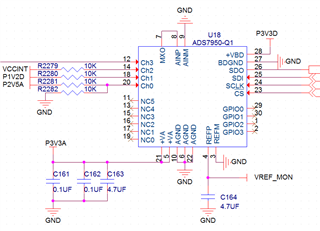

I use two pcs ADS7950 in my circuit. Under the condition that the power supply voltage of PCBA rises slowly, ADC sampling value cannot be read,nor when I rboot the FPGA on the PCBA  . I guess  that the ADC  power-on abnormally , May I ask whether it is related to the power-on time sequence of +VA,+VB and CHx? Could you please give me some relevant guidance or suggestions?

  • Hi  Art,
          Here is my schematic ,it seems to have two questions,
               1、no capactior is placed at the +VBD, is it necessary? What problems may  this cause?
               2、P2V5 is alreadly existing  before the supply is powered up.
    Qi Liu
  • Sorry for the late response.
    1. Yes, a capacitor is required on VBD.  You always need to decouple all supplies on all devices.  Decoupling provides a charge reservoir on the supply pin to respond to transients.  Without decoupling your performance may be impacted, and you may posibly have device malfunction.  Probably the most critical supply to bypass is a digital supply as the transients will be large and will generate noise issues without decoupling.  This video on decoupling capacitors will help you to understand the importance of this component.
    2. Applying power to an input of an ADC, before applying it's analog and digital supplies violates the absolute maximum conditions.  This is not recommended and can result in abnormal operation or damage to the device.  In your case, you have a current limiting resistor which should help reduce the possibility of damage.  This criteria of applying the power supplies before applying signal to the input is universally true for ADC and amplifiers (this isn't specific to this particular device).  Thus, if you cannot avoid this condition, limiting the input current is a good thing to do.  Also, you could limit the input voltage using external diodes as is shown in this document: op amp protection for SAR overstress
    I hope this  is helpful to you.  Amplifier Overstress Videos  and Data Converter Overstress Videos cover these topics in detail.
    Art
