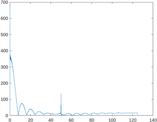

    May I ask what are the sources of the signal?  Is/Are the source(s) stable/steady/still?
    Is the baseline drifting periodic? can you record the baseline only without signal and do some FFT to figure out whether there is any tone or frequency?
    Could you find&try some steady source of signal and use proper wire/cable to test first? E.g. any ECG, EEG or EMG simulator.

    2. I'm not sure if it's periodic. Here's the baseline without any triggers. Attaching a clipped version too without the initial transients.
    Here's the FFT of the same signal:
    3. I'll update you on a steady signal source output at the earliest.
    Warning/disclaimer: "TI never suggests nor recommends to directly use EVM to interact/contact with human body!!"
    Please use some steady/stable signal sources mentioned previously.
    Again, it could be wires/cables and their length and shielding also contribute to drift.
    Skin conditions, hairs also matter/affect.
    You will probably need to design some analog and/or digital filter to reduce the drift.
