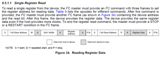

    I'm following the the 7128 Data sheet on page 27, section 8.5.1.1 Single Register Read ,
    to attempt to have the 7128 send the PIN_CFG register contents back to my TMS320F280039C MCU, but am running into problems at the moment. below is a screenshot of the various commands i am trying to implement where SINGLE_REGISTER_READ = 0001 0000b and ADC_PIN_CFG_REGISTER_ADDRESS = 0x5  in accordance with the 7128 data sheet. line 75 is the 7bit slave address and the write bit(low).

    Here is a screen shot of reading the PIN_CFG register:
    I'm at address 0x10, so write single register read command (opcode 0x10), from the PIN_CFG register (address 0x05) and then read the contents.  In my case they are 0x00.
