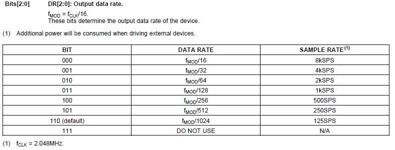

    As for your questions, I see you're asking for system clock and SCLK settings. The table describing configuration register 1 on page 42 of the ADS1198 datasheet will be of interest for your system clock questions, inserted below:
    It's important to note the addendum at the end of this datasheet snippet ("(1) fCLK = 2.048MHz"). With fCLK = 2.048MHz and bits 2:0 set to 101 (fMOD/512) we get 250SPS, which is very close to your desired 256SPS. If we work this in reverse we can find your fCLK frequency...
    fMOD = 256 (Desired sample rate) * 512 (divider set by bits 2:0) = 131072 Hz or 0.131072 MHz.
    fMOD = fCLK/16 (as per the note at the top of the snippet above)
    fCLK = 0.131072 MHz * 16 = 2.097152 MHz
    As you can see, the fCLK frequency is close to 2.048MHz, as expected. You can play around with these divider numbers until you can find a clock source that is able to create the frequency you're interested in.
