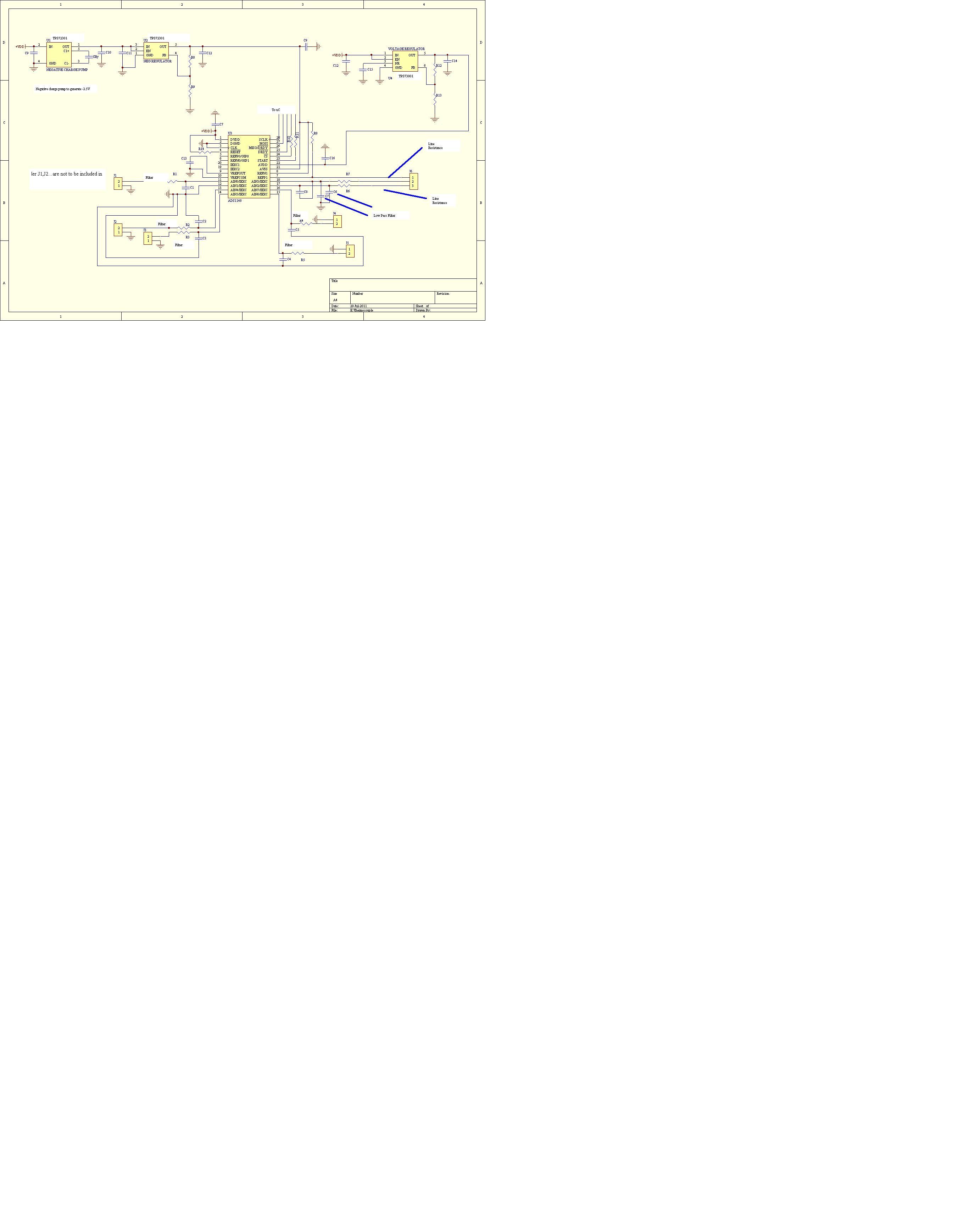

Actually, we are designing the circuit using ADS1148. We need to provide analog as well as digital supply. I am planning to have the connection to both the pins from the same supply, so how do I separate the noise from each other? Do i need to have a inductor for DC supply?

  • Hi Himanshu,
    Which voltage regulator and charge pump are you using? Specifically, at what frequency do they switch at? Using regulators with switching frequencies near the sampling rate of the oversampled delta sigma modulator can significantly degrade noise performance by aliasing into the sampling band. When finding a regulator, I'd suggest looking for a very low ripple one that switches at frequencies that are not integer multiples of the modulator sampling.
    For the ADS1148 and ADS1248 families this corresponds to 32kHz, 128kHz, 256kHz and 512kHz depending on your selected data rate. Even small <5mV ripples at these frequencies can cause degredation without adequate decoupling. It will be very important to provide a significant decoupling capacitance near the ADC and output of the supply source.

  • Hi Mike,
    Thanx, I didn't knew that switching frequency can be so much important. I am attaching the schematic diagram for your reference.  We are using the bipolar supplies AVDD and AVDS. The regulator used are tps72301 as negative LDO, tps73001 as positive LDO and the charge pump used is tps60403. The switching frequency for charge pump is variable but for the LDOs I am not sure.
    I would like to know as how do we switch the frequency of the charge pump or LDOs. As can be seen from the schematic, we have already placed the decoupling capacitors near the supply line.

  • Hello Himanshu,
     The TPS72301 and TPS73001 are low noise linear regulators; so they don't produce switching noise.
    The TPS60403 charge pump has a switching frequency of approximately ~180kHz to 240kHz depending on input voltage and temperature; referring to Fig19 on page 11 of the datasheet.  The other options are the TPS60402 with ~50kHz and  TPS60401 with ~ 22kHz. You may post in the Power Management forum if you need more details for these devices.
    The modulator frequencies for the ADS1148  vs data rate are given on Table 7 page 17. As Mike mentioned, you can make the decision of the charge pump depending on data rate that you expect to use, choosing one that switches at frequencies that are not integer multiples of the modulator sampling.  As mentioned before, using decoupling capacitors at the supply pins of the converters, at the outputs and inputs of the LDO's and at the outputs and inputs of the charge pump will help.  Good board layout considerations (isolating the charge pump) and good grounding techniques are also important.  Using appropiate anti-aliasing filters at the inputs of the ADS1148 will help.  Since you are targeting a 16-bit resolution requirement with the ADS1148, you should be able to obtain optimal results; higher resolution measurements could be more challenging.
