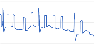

I'm using a ADS1292 and have problems with spikes in my ECG. I take only the raw samples over the SPI interface for two channels and sometimes I find spikes in the ECG. There are no filters activated. Only the raw data from ADS1292.
This is the picture:
This is the raw data and there is a jump from 0xFCC4DB to 0xFD2DC6 and later after several samples the jump is back from 0xFD18EB to 0xFCCF85.

Have you an idea where the spikes came from? They are sometimes in the ECG raw data.
Can this be a timing problem of the SPI interface?

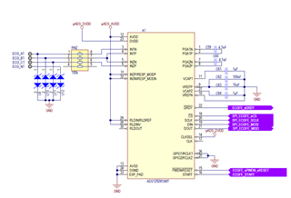

  • Find here our schematic:
    We have one electrode using for channel 1 and channel 2.

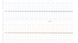

    Please check if you could read the Device/Revision ID correctly or not?
    Then Check if you could read the internal test signal correctly or not?
    signal source are dry electrodes of stainless steel.
    The Device/Revision ID can read correctly and the square wave test signal looks like this:
