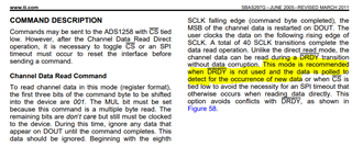

The read command 0x30 is sending. So it is mentioned in the datasheet that the channel data read (register format) is recommended when DRDY is not used.
So how will I get the real time ADC value without the DRDY.
Thank You
FAHAD K R
  • Hi FAHAD K R,
    As stated in the datasheet, use the channel data read command if you are not using DRDY to indicate when new data is ready. You will instead need to poll the STATUS byte to see when new data is ready. Both of these sections of the datasheet are shown below
    -Bryan

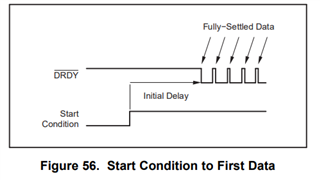

  • Hi FAHAD K R,
    Thanks for the additional information
    Can you take the START pin high and probe the DRDY pin? You do not need to have DRDY connected to the controller (it appears you don't), you can just probe it with the scope. The DRDY pin should pulse at approximately the 1/data rate, similar to the image below. This indicates that the ADC is at least operating (the supplies are valid and the crystal / clock is functioning). Let me know if you are able to see this behavior
    I also noticed that in the scope shot you sent that DOUT is always high (you said you are seeing 0xFF). Do you have a pull-up on this pin in your controller? I would expect that DOUT would return low at some point, but this does not seem to be the case in your system. If your DOUT pin is being driven by the controller, you won't see valid data
    Let me know
