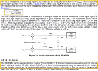

my customer has a question regarding the impedance formula show below.
I just would like to have a confirmation:
Is fMOD the CLKIN frequency or the CLKOUT frequency (fCLKIN / 2)?
I guess it is the CLKOUT one but I am not sure.
Could you please confirm me this point?
