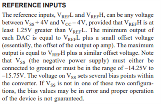

  • Hi Shinichi-san,
    I reviewed the datasheet in more detail and it does not look like the DAC7744 can operate with ±5V supplies. The part itself was designed to work at the higher supply range only.
    The electrical characteristics table mentions the maximum and minimum supplies:
    Later in the datasheet, it mentions that a negative supply other than -15V or ground can cause improper operation. It also looks like this device has a greater headroom requirement of 4V while the DAC7644 requires 2.25V of headroom. That likely won't work for the customer's application based on a 5V supply.
    Katlynne Jones
