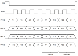

    2. Will the RF frequency hopping time, including the configuration of 64 bits of the NCO using the fast reconfiguration interface clocked at 200 MHz, come below 200 ns?

    As for the FR interface,
    The datasheet specs 60ns of reconfiguration time for a 32 bit word. This is due to 4 clock cycles needed for the R/W bit along with address bits. Then 4 8bit registers writes (FR interface auto increments address), Each 8 bit word requires 2 clock cycles, meaning 8 additional clock cycles. A total of 12 clock cycles are needed to write the 32 bit word and therefore 12*5us (200MHz clock) = 60ns.
    Extending this to a 64 bit frequency word update would require 8 8bit registers to be written, so 4 clock cycles + 16 clock cycles (2 per word) means a total of 20 clock cycles = 100ns.
    If the DAC is configured for the FR CS~ to toggle the frequency word update, the device will update the frequency in the NCO very quickly once FR CS is pulled high (The interface is the dominating latency contributor). So 200ns is obtainable with an FR clock that's just a bit over 100MHz.
