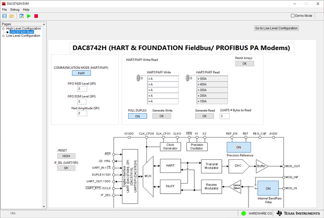

I have DAC8742HEVM Development Kit and I try to test the kit using DAC8742HEVM GUI Software.
In that software I already can send and receive some data in SPI Mode for HART and PAFF communication.
I made the pin configuration like this:
But when I try using UART mode, I didn't receive any data.
Could you help me about this issue?

  • Dear Lucas,
    I set this configuration on GUI:
    Here is the data that I receive for PAFF Communication in SPI Mode:
    But for PAFF Communication in UART Mode, I still didn't get any data. I use 57600bps, 8N1 seial configuration.
    Could you give me some advice?
    Thank you for your help.
    Ibrahim

  • Dear Lucas,
    In the first picture I send data with the value "AAAAA" via PAFF Protocol and SPI Mode.
    In the second picture I captured the data sent by the first image (AAAAA) through UARTOUT Pin.
    Thank you,
    Ibrahim

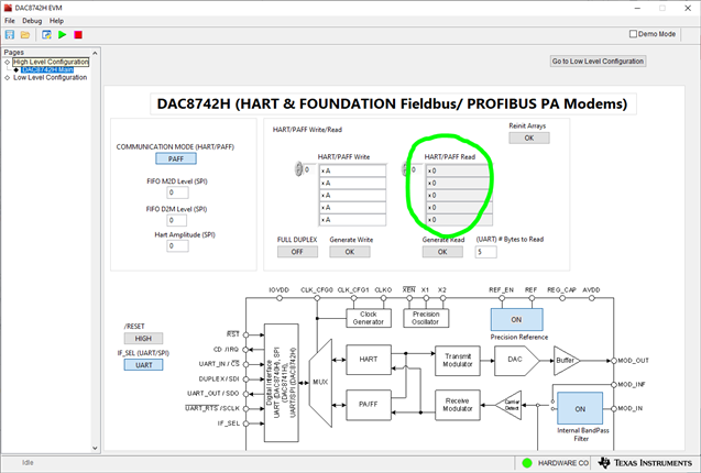

  • Dear Joseph,
    I try to send some data (AAAAA) via PAFF Protocol and in SPI Mode:
    And I try to capture the data through UARTIN Pin and I able to get the UART data:
    But in DAC8742H EVM GUI I didn't get any data:
    Thank you,
    Ibrahim
  • Hi Ibrahim,
    For UART PAFF communication, there needs to be 4 bytes at the beginning of the UART transmit to configure the PAFF settings.
    I don't think it will send if these aren't provided.
    Can you try sending EA 99 00 AE as your first 4 bytes and then include any data bytes after it in the same write?
    Ex: EA 99 00 AE 12 34 56 78 90 ?
    Lucas

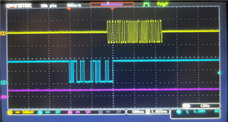

  • Ibrahim,
    I haven't completely gotten it to work, but I am closer to it.
    I set up the board just so that I could see the PAFF signal, but haven't run it back yet to the MOD_IN to check the receive of the PAFF signal. Here I just send the MOD_OUT to a wire just to view that the PAFF comes out.
    Here are the jumper settings for the board. The main things that I needed to check were the setting for JP15, so that the signal going into CLK_CFG0 is midway between IOVDD. This is achieved setting JP15 and JP17 shunt the jumpers. After that, I want to use the 4MHz crystal, so I set JP1 and JP2 to the 2 to 3 shunt. Also, I want to use UART as the interface, so I set IF_SEL to ground shunting 2 to 3 on JP13. You can see the settings, on the diagram on the board.
    I need to check the settings for JP6, JP10, JP11, and JP16, I should be able to get a signal to MOD_OUT.
    After that, I set the configuration on the GUI. I set IF_SEL to UART, set COMMUNICATION MODE to PAFF, Enable the internal reference, and then set MOD_IN to internal bandpass filter. Then, I set the HART/PAFF write to 0xEA, 0x90, 0x00, 0xAE, 0x01, 0x02. I think Lucas's suggestion of the first four specific bytes are required for transmission.
    At this point, I can look at the UARTIN signal sending the data to the device, and then I can see the MOD_OUT sending the PAFF signal. Here's what it looks like with an oscilloscope.
    The blue trace is the UART signal, the yellow trace is MOD_OUT, and the pink signal is just the internal reference. Again, I haven't tried to loop the PAFF signal to MOD_IN yet, but that's the next step. I just wanted to make sure that I can see the PAFF signal on MOD_OUT.

  • Ibrahim,
    I think the EVM works with the setup I described in the previous post. I connected the MOD_OUT to MOD_IN and ran the device in the same way. With this connection, in full duplex I re-connected the scope and looked at the MOD_OUT, UARTIN, and UARTOUT lines. Yellow is MOD_OUT, blue is UARTIN, and pink is UARTOUT. Again, I sent a sequence of 0xEA 0x90 0x00 0xAE 0x01 0x02. This is what it looks like after I send the same sequence:
    Here it is again, with a close up of the transmission side, particularly for UARTOUT:
    For the read, I did set the stack to read 2 bytes and I was able to generate the read and get the last two bytes:
    This looks like it works. You can see the UARTOUT from the scope, and you get the same thing from the GUI.
    Joseph Wu
