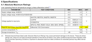

Hello team,
The peak input power for this device is 12dBm (Abs Max).
Is 12dBm, for each of the input pins? (INA1P, INA1M, INA2P, INA2M, INB1P, INB1M, INB2P, INB2M)
OR is 12dBm for each of the input differential pairs? (INA1P & INA1M)
My customer is planning to use (INA1P, INA1M, INA2P, INA2M), is this mean that customer can input total of 18dBm?
